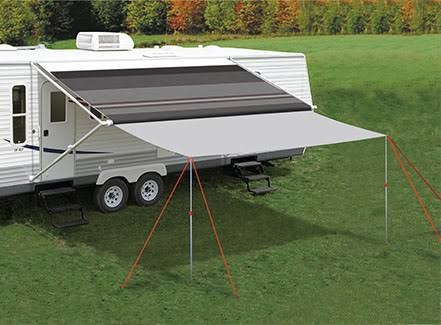

Hi everyone. Searching the internet for suppliers of awning extensions with poles but can only seem to find suppliers from USA. Not looking at extensions for end of awning but only for the main part of the awning extending from the side of the caravan.
Yes I have possum3 but haven't the room to carry it. Just thinking of about an 8ft extension with the poles. Thanks for replying.

You are not very clear as to what you require. Are you wanting to extend the shade to the side of the awning from the roller out?
If so then construct the type of awning sheet that attaches to a sail track on the side of the van. This is a shet of canvas or vinyl awning material with a 6 mm rope sewn into one side and some eyelets on the other. You slide the rope side into the spare slot in the roller and support the other side with tent poles and ropes in the eyelets. any canvas manufacturer can make it up for you.

You could consider buying a tarp, to suit your needs. Then you will need to have one side cut off and then sew a suitable rope to this end so as to slip into the slot ( track) on the awning pole. Then purchase the necessary extension poles and ropes.
We purchased a large 5 x 5 metre shade cloth via the ebay and cut in half and then had a sail maker sew the required rope to each cut side. This was great for the awning extension, and the other half we attach via a track to the off side of the van to protect the fridge from the summer heat.

Ok...got it. PeterD ....yes. That is what I am planning. I know they sell them in the US. I was hoping to find them as an accessory here is Australia. It seems like I buy an appropriate shade and have it modified.
I have attached an image of the item as they sell it in the US.
Thanks again for your advice everyone.
When we started experementing with our awnings we did as Jay & Dee did, only the navigator used my old sewing machine with a zipper foot and sewed the 6 mm rope into the edge of cut down cheap tarps. When we got things as we liked them we went to a canvas/tent maker. They have good 2.5 meter wide material that makes the awings much neater than modifying something. We used to ask what but ends/end of roll suitable material they had and got it much cheaper that way. Go to a canvas maker with your design and get a quote, you are under no oblogation to accept the quote.

Could a shade screen be used ? With poles and rope to hold it up higher ?

That's exactly what we do.

Yes, we and others we know use the front privacy screen, put it out on some poles and ropes, and you have extra shade, and a much larger area for seating.

Thanks again everyone. A shade screen with poles seems to be the way to go.

We have been using shade screens - one for the side and one for an end. They certainly make an immediate effect on the temp under the awning.
When it rains we reduce the angle of the screen. There seems to be a sweet spot or angle where the most of the rain runs off and doesnt go through the mesh.
