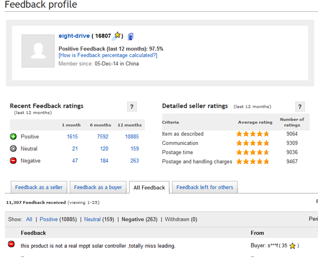

Jaahn has given some good advice here
The picture below is the profile of the eBay seller above Note the very last line, where someone had brought the MPPT solar controller, and said that it was not a real MPPT one

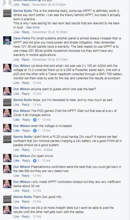

El Gringo said
12:40 PM Dec 1, 2017
I have been involved in a discussion on this subject on a Facebook group. I too have genuinely wondered what is really best for RV systems. I have seen the claims and all the people that recon your an idiot if you can't understand why their so much better. but trying to find the side by side test results to prove it seems almost impossible.
(there are some on youtube etc but I have yet to find one applicable to where we live - tropical/temperate zones, not arctic)
Posted screen capture below shows real time testing done in Australia in a side by side environment. The PWM was more than 20% better than the Tracer MPPT.
This test was done by a guy who recommends MPPT and uses them on rooftop domestic systems 'all the time' It therefore seems to me the only benefit from a MPPT controller is when you want to run series connect panels and high voltage. This will save you some money in copper wire, but does it actually work any better, I certainly can't see it saving any money overall.

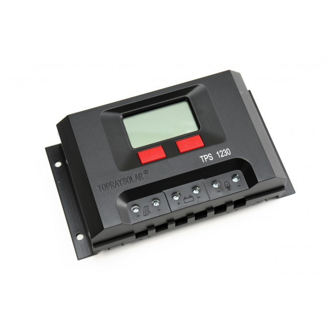

Something like this I wonder.
https://www.ebay.com.au/itm/Solar-Panel-Regulator-LCD-10-20-30-40A-12V-24V-MPPT-Charge-Controller-3-Timer-ER/162576900606?ssPageName=STRK%3AMEBIDX%3AIT&var=461581453898&_trksid=p2055119.m1438.l2649

It has been shown, often, that the cheap MPPT regs like the one above are FAKES ! They may work OK as PWM regs but have no internals to boost the output current.
There are lots of FAKES on ebay.

https://camec.com/solar-charge-regulator-30-amp-12-volt-camec-400-watt-panel-power-max.html
This is branded different but looks the same as I have. The link you supplied Paul is I think you will find is a PWM not a MPPT as it says.
Cheers, John.
Thought provoking result???
