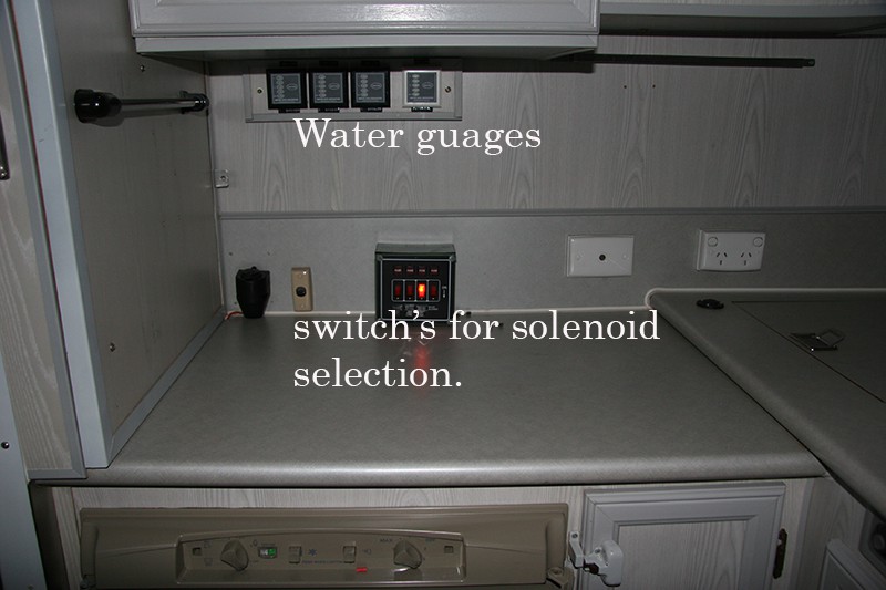

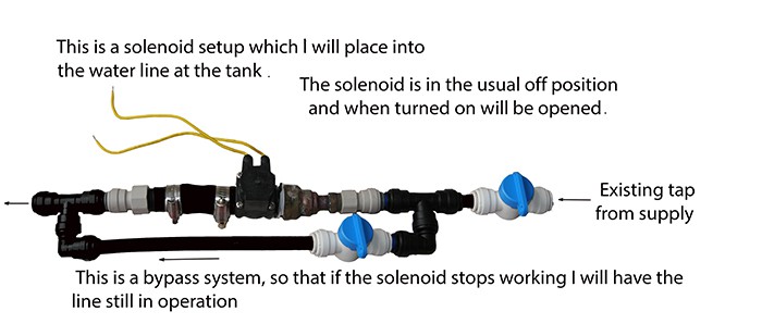

dieseltojo said
01:04 PM Nov 20, 2017

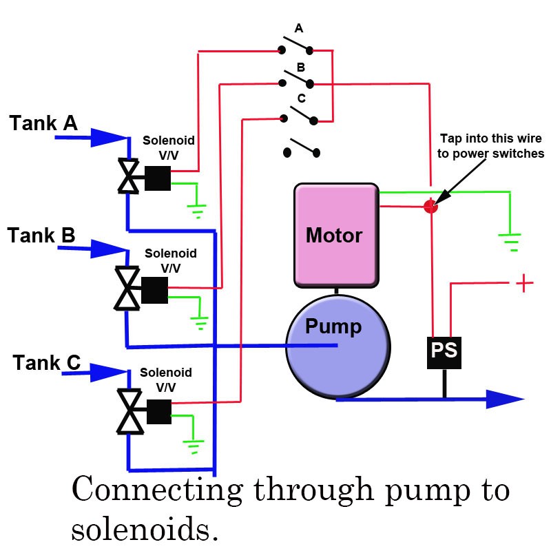

Aussie Paul, It is a thing that can be done a lot of ways; how ever this is how I did the job for three tanks. That was 7 years ago with no problems.
Unfortunately the pics are gone from this post I made a while back, but the info is still usable.
The wiring is done so it goes to the solenoid to the pump. Once a tank is selected and turned on the solenoid will open at the tuning on of a tap. Not only can I now control every tank separately, I can say empty one tank and if free camping just fill it from a river with out interfering with drinking supply.
Every tank should have a tap to shut it down in case of damage.
I have to say mate if you do not understand any of this info, get a friendly electrician to do the bits you don't get.
The solenoids were from Bunnings made for garden water systems.
The wiring is not polarity specific, as long as you do each one the same, and just put a switch board in the van.
I installed them in the default closed position.
The extra loop in the manifold is just in case of a malfunction you can go back to a manual control system. I have never had to.
Most " garden valves" are 24v ac. There are 12v dc , often special order, so don't grab wrong ones. cheers Craig

aussie_paul said
10:37 PM Nov 21, 2017
Thanks for that Paul (dieseltojo), makes good sense re the solenoid current draw.

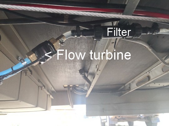

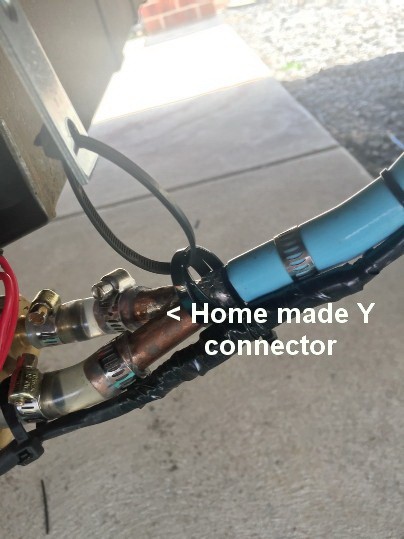

aussie_paul said
12:37 PM Dec 2, 2017
Hi dieseltojo, would you have a brand and/or model number for the switch you used?

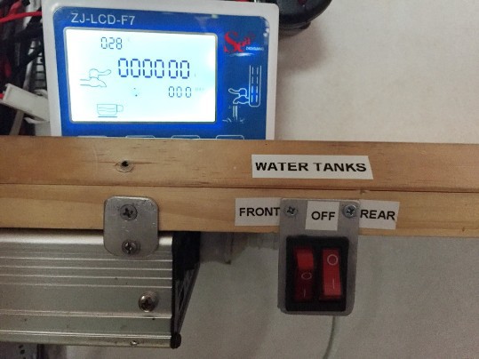

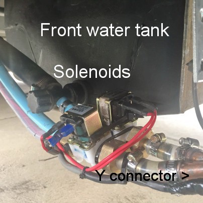

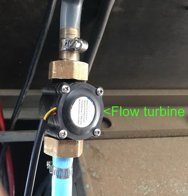

It has taken me a few weeks to achieve the desired result. Thanks for the advice and suggestions from members. I wanted to achieve the remote changing of the water tanks as well as the best possible shower pressure by eliminating as many elbows etc that reduce flow.
Festive season played havoc with time frames, and of course waiting for online purchases to arrive!! I was sick and tired of laying on blue metal so decided to back van in to concrete driveway. That and some foan mats made the jobe easier. With the heat and my chronic exhaustion etc I have just had to pace myself.
I have placed the two solenoids inline and side by side near the front tank, through a home made Y connector, through the flow meter turbine and then through the filter to the pump. I will install a shut off tap at each tank when they arrive.
Electrically I used the suggestion of dieselyojo (Paul) and took the + lead from pump side of the pump pressure switch. I would never have thought of that!! Solenoid only draws current when pump is actually running.
Ran the wires up through the floor in the small cupboard where Jayco have the water filler and breather hoses connected.. Then followed the other cabling I have run for solar, inverter etc to where I can reach from my recliner. I can select either tank or both and also monitor the flow and liter counting meter.
While waiting for parts to remove the Setec from and tidying the DC circuit I am thinking about how to change water tanks without having to lay or reach under the van to the jayco 3 way tap. Thinking possibly a 12v solenoid at each outlet. Trouble is they drag 500 milliamps. Possibly a linear actuator to a lever on a 3 way tap. The Jayco tap has to be mover 180 degrees making it harder to actuate. 90 would be ideal.
Any thoughts please?
http://www.candm.com.au/forum/viewtopic.php?f=43&t=13785
