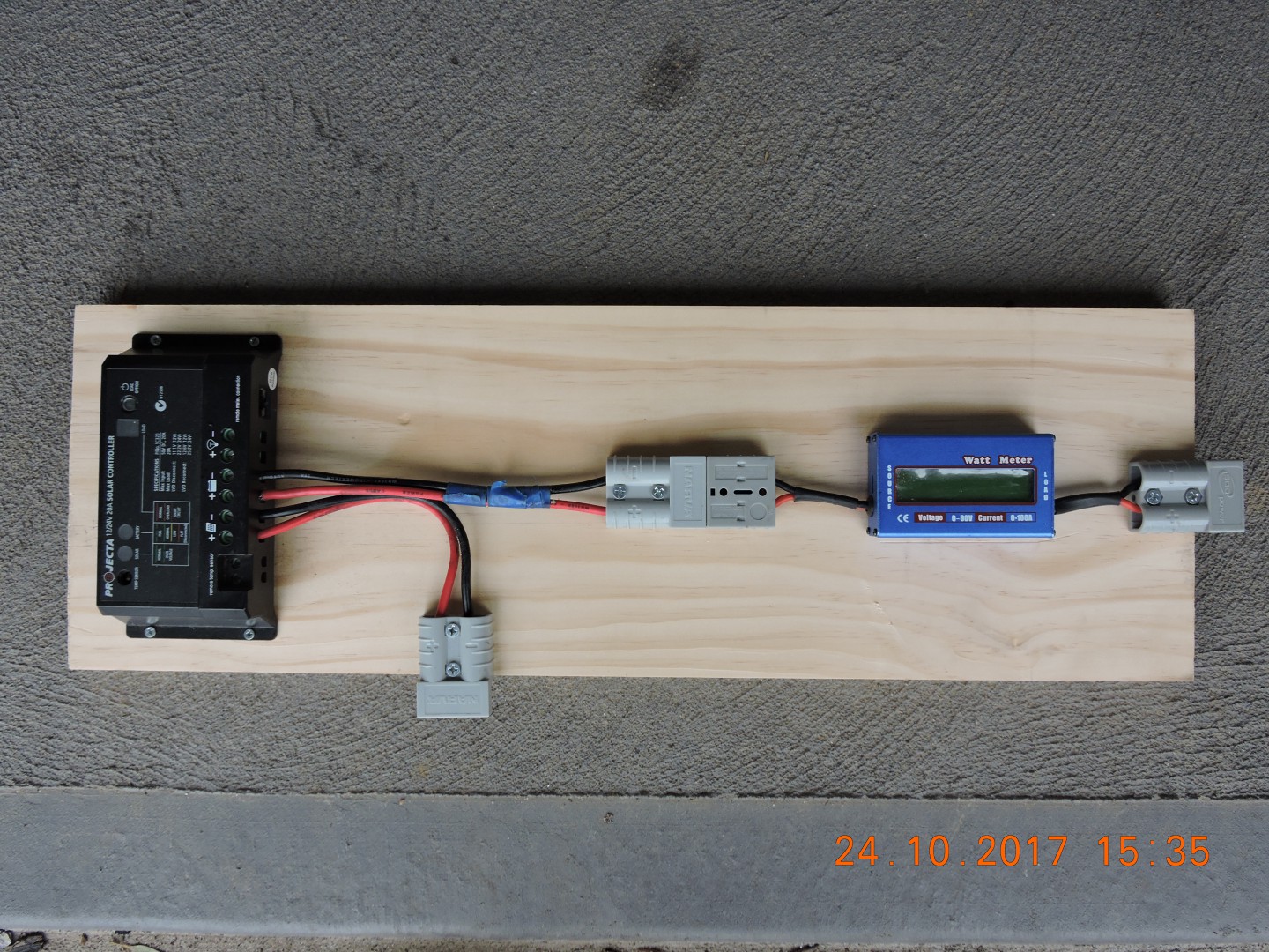

Hi there. I run the leads from my portable solar panels to the solar controller ( Projecta 20 amp ) and then in to the anderson plug which normally charges the batteries from the alternator when travelling This way the lead into the van is only about two to three meters. To save the leads being pulled out tangled etc I have made up this board in the photo, Cheers Daz
That looks great dazza that would plug straight into the Anderson plug on the side of the van that's already connected to the battery,and the other end would simply feed the panels,much appreciated I will make one up...

The watt meter is good . Gives you a read out of the amps put in over the day as well as the instant amp feed as well as the current battery voltage. Lets you know that your panels are working. About $35. Look up kickass on the net and you will find them there, or any online 12 volt supplier. Cheers. Daz

This simple yet extremely handy device gives a digital display of exactly how much charge your panels are actually producing. It has been difficult to measure this without special equipment or expert knowledge - until now!
The device is easily installed and provides you with all the key ratings of your solar panels in real time.This is a perfect companion to our range of KickAss Portable Solar Panels but can be used with any type of solar panel as well.
Installation is easy - the watt meter has two Anderson plugs, and is installed in-line between your solar regulator and batteries/load.
Simply connect the solar panel regulator's output to the "source" side of the watt meter and connect the battery/load cabling to the "load" side. Once there is power flowing through, the device will initialise and show you a full range of ratings including:
Current (Amps/A) at the present moment
Voltage (Volts/V) at the present moment
Power (Watts/W) at the present moment
Total Amps (Amp hours/Ah) since device initialised
Total Power (Watt hours/Wh) since device initialised
Highest Voltage Maximum (Vm) since device initialised
Highest Power Peak (Watt Peak/Wp) since device initialised
Highest Current Peak (Amp Peak/Ap) since device initialised
The Solar Watt Meter only requires a tiny 7mA draw to operate so there will be no significant reduction in your power production during usage.

I have the watt meter and put Anderson type plugs on, like Paul, I was also concerned about the small wires on the meter
Using it with a portable panel, it was good to see what was happening
Being sometimes "a bit too smart for my own good", I connected two more Anderson type plugs near the battery between a fixed roof solar panel It worked OK until the next morning Next morning it allowed the current to flow to the battery, but the screen was blank I figured out that you had to firstly connect it to the solar , and then secondly to the battery
Being connected between the fixed roof solar panel, and the battery, in the morning when the solar started working, was like connecting it to the battery first By just pulling the battery side of the Anderson type plugs apart for a few minutes, then reconnecting, everything was good, until the following morning, etc Perhaps I had purchased only a copy, of a genuine copy, because I only paid about $8 for it
the watt meter where ,how much,is it useful

Looks like a bargain Daz amazing that anything that's any good can be manufactured for that price..
the wiring on the solar control is straight forward .the spare terminal with the light bulb icon, I take it that's for a meter to be connected to I guess..
-- Edited by Ron-D on Wednesday 25th of October 2017 08:49:14 AM
The Solar Watt Meter only requires a tiny 7mA draw to operate so there will be no significant reduction in your power production during usage.Hi Ron The above is from the Australian Direct ( Kickass ) website
Currently $35 with Anderson Plug connectors. There are cheaper on EBay but they have no connectors
I have no affiliation with Australian Direct but I have found them very good in the past and what I do like is that you can ring and talk to some one. '
I have never used the auxiliary on the meter but think you could use it as a 12 volt power supply. Not much use that I can see.
As I said in an early post the meter lets you see what amps / watts is being supplied and the voltage of your battery.
Cheers Daz

I am not an Electrician
