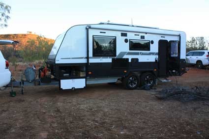

Doing to much reading about different vans. The Vans will be new they are Galaxy Defender 20feet, Crusader Excalibur Duke 20.6feet lots of mods to it for our likes or a Olympic Champion 21.6 feet made with what we want. The Olympic dealer is local and have a lot of confidence in them providing a van we will enjoy. All vans will be composite with pay load of more then 700kg. This allows for 500kg and 200kg of water, will have gray water tank. The vans are to be used for long travel and some free camping while travelling and working some times while on the road. Thoughts and suggestions appreciated as this will be the first van I have owed normal have an old camper. Will most likely the tug will be a 2nd hand landCruiser. Thanks

Hi I agree and do not buy many things new the tug will be second hand. Looking at van I was going to buy secondhand but the reason I am looking at new is to make it compliant, Working with some of the manufactures you can increase axles, tiers, suspension and frame to be able you to have more weight in van so if both GVM are in the limits and your CGVM is right you are Ok I think? It would be more costly to do this to an older van and get it ATM changed or is there away that it can be done for a reasonable price. Yes I am considering a smaller van but wife is the problem and the overall tow length changes less the van length. So as a first timer and it my be our home for long stints it may be a compromise. Lots to think about.

We have recently changed our Crusader X-Country for a Crusader Excalibur Duke. We had Dexter anti-sway fitted, more solar a large tunnel boot with appropriate door, a compressor 190L fridge, a Truma heater (gas) and X-Country suspension. It rides very well behind the car (200 Series), in fact we are hardly aware that it is there. We went away in it for 8 weeks recently and loved its comfort and layout. So did our small dog!
We were unable to have a shakedown trip to find any flaws. We did have some issues while away. The screen door had not been fitted properly and so we had to be careful with it till we got back. The other thing to watch for is the sliding bathroom door. If not locked down properly it will come off its runners when travelling.
When we got home we took it back to the dealer and all was fixed. It's now in storage awaiting a new trip next month.
