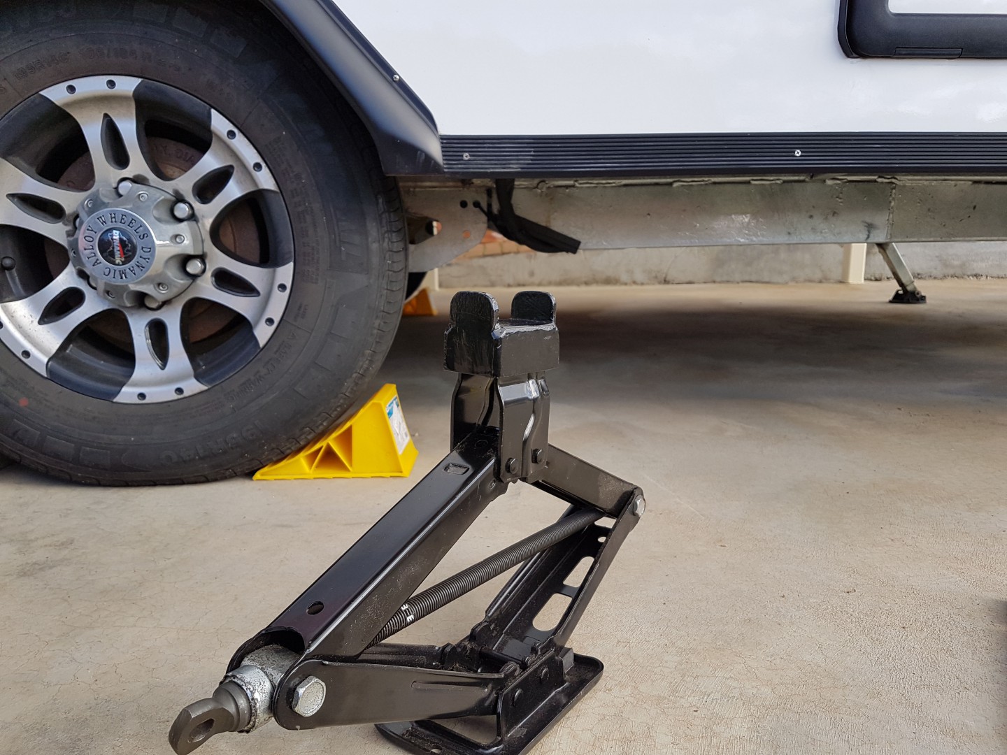

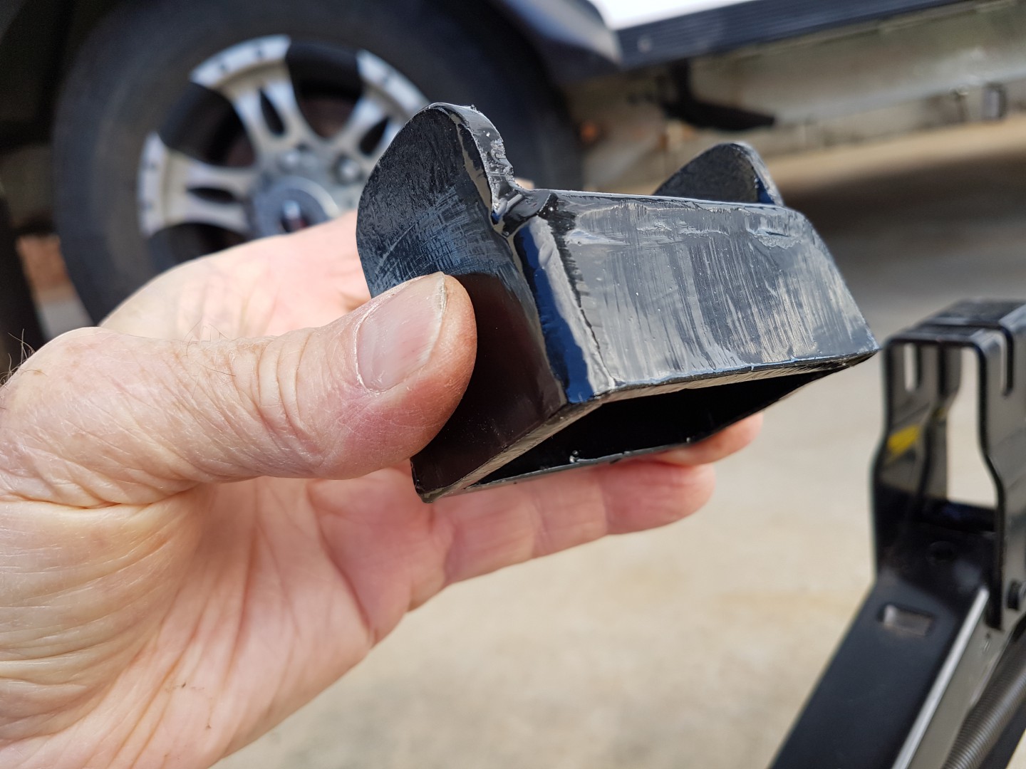

Hi all this might interest some who only want to carry one jack instead of two and are handy with metal work. I first checked out the suitability for my jack to the caravan. I checked that it was within the load rating to lift the van and that it went high enough to lift the van. The lifting point on my van is where the RHS drawbar comes close to the wheel. I made an adaptor to go ontop of my Santa Fe jack with two lugs to stop it from slipping off the RHS.
It will keep the jack slipping off the chassis, and as you point out, you now only have to carry the one jack

I have made an attachment which sits over the head of the jack, and enters the jacking hole of the chassis

Hi Tony, yes you would be in the same boat with a bottle jack and have solved your problem in a similar way.

Thanks Sandman 55 I appreciate the link.By the way I made up an adaptor for my Ranger jack to fit the camper just an hour ago,I made mine up with
2"x2" RHS cut in half with a piece of 2"pipe to go over the jack.

Hi Graeme I'm glad it all worked out I had some 90mmx90mmx5mm that I cut down into flat steel and welded it all together. I use what is at hand. I might have to make up another next year and I will remember your 2"x2" RHS cut in half because I want to upgrade my Santa Fe to a dual cab ute and a Ranger is one consideration also I want to test drive a Triton as we only have a small van. A big deciding factor it the comfort of the ride and the Ranger has some good reports and I am yet to find out about the Triton. Our problem is we are near to our ATM limit with our van so with a dual cab with a canopy we can load that up instead of the van.
