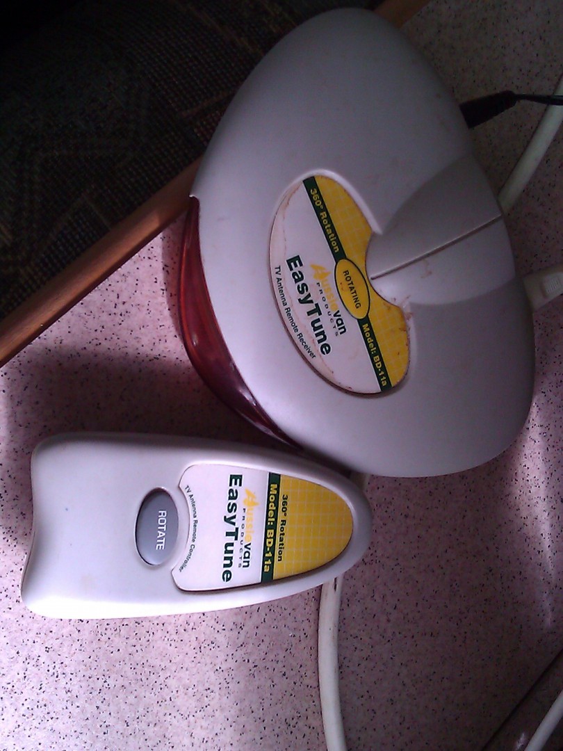

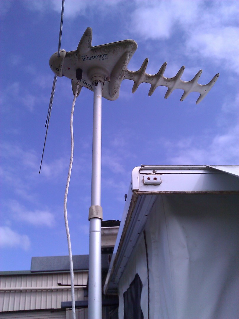

Hi, I am a total novice at this, but on the 2001 Jayco caravan I bought is this antenna (I'll try to attach photos) and device inside; "Aussie-Van Easy-Tune". Is this still current for watching TV while on the road? Or is it an obsolete system? There is a small flat-screen TV in the van attached to the cables. I cannot test it while at home because where the van is parked is no TV reception whatsoever, unfortunately. Thanks for advice.
Looks OK but also looks as though it has been around for a while so could be worth looking into a replacement.
I also notice you have been around for a while and that you have asked a few questions but can't find any replies to let people know if things worked out for you or not.

What you have is similar to what I had in my Jayco Eagle - the first was handled by Happy Wanderer in Adelaide (it cost around $180). I had it for a number of years & didn't go without being able to watch TV. However, not long before my Eagle found a new owner, the unit failed & I replaced it with a similar unit handled by Jaycar Electronics. See www.jaycar.com.au/outdoor-uhf-vhf-marine-tv-antenna-with-rotation-motor/p/LT3143.
It cost significantly less at around $65 & it worked ok. Both of these required a 12v connection to power the amplifier built into the antenna.
You said it doesn't work at home - does TV work in your house? If the van's TV isn't working, it could be missing the 12v feed.
With UHF digital stations (all of our tv is that now), you do not need to have the single dipoles extended. Most stations have signals that are horizontal polarisation - therefore you put your powered unit in a horizontal plane but some are vertical polarised & you must have the unit in a vertical position. There should have been an adaptor in the kit to enable this. You will need to rotate the aerial/pole for the best reception.
Look - satellite dishes are fine but you need to be able to store all of the gear too. I never had any issues with the system I had in the Eagle - I was always able to see TV in most places.

Our experience with TV. Every where now is digital so that does not carry far like the good old days. But in most reasonable size towns there is a repeater aerial so if you stay in caravan parks close to towns or populated areas you will get something. If you want to free camp in the parks and forests or down by the river etc then probably no signal.
But as has been said the signal can be horizontal, which suits the way your aerial is mounted, or vertical poralised which needs your aerial mounted on its side. I just look at the other aerials on the houses as I get drive in to the place to give me the idea. Looking at other caravans can be confusing as they often point everywhere and most do not work well most likely The change of "polarisation" from one transmitter to the next is to prevent interference of the adjacent signals from one area to the next.
Give it a go and try it out or take a DVD player and some discs. Or listen to the call of nature ! Or get a satelite system if you like the free camping after a while. Good luck trying it out.
Jaahn
09:17 AM Sep 21, 2017
People (particularly salesmen) get hung up on "digital antennas." All an antenna does is pick up electrical signals. It does not worry about the content of the signals, the TV does that. Nothing has changed with the nature of the signals in the 60 years I have been dealing with them, it is just what has been modulated on them that has changed.
You say there is no signal in your location to test things. The problem with amplified antennas such as yours is the amplifier sometimes fails, there is no expiry date, they can last for ever or fail in the first few years of operation. You will not be able to test it until you get into a TV reception area.
One thing you have to watch with amplified antennas is in some cities he signal is so strong that it overloads the amplifier. That blocks signals getting through. Sometimes you can point the back of the antenna to the transmitter to reduce the amount of signal picked up. In some antennas you can switch the amplifier off and get reception. Just recently at Riverside in Townsville I ended up with the antenna on the gas bottles to get a watch-able picture.

Me again, Tigerchips - yes I agree with PeterD's comments regarding the over loaded amplifiers.
Generally these can produce spurious frequencies (ie a signal that wasn't supposed to be present & could jam a correct signal depending on the level & frequency) that can interfere with mobile phone towers. I won't get into the technical bits & the mathematics here. When I worked for Telstra in Townsville, we had a fault come through for Karumba & it took some time for the fault to be allocated to the correct tech based at Normanton (as people who are upset about Telstra's response these days can concur). The fault was traced to a caravan park in Karumba but the culprit left before he could be found.
Peter, you may have got away without an antenna at Riverside as the transmitter was just up the hill on Mt Stuart.
