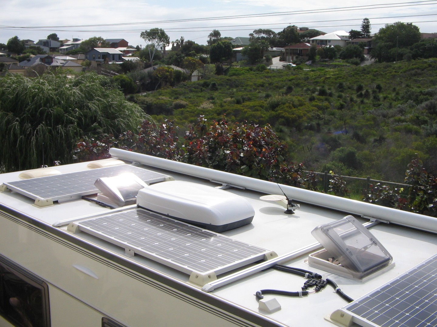

lots of Nat Parks are generator free (thank god) we have 600 watts on roof ,3k inverter and use microwave etc

That's a neat installation Davey 123. Just be aware when installing solar panels, a shadow over one or two cells can take out the entire panel, I have made the mistake of installing a panel too close to the air con.

Iana yes take your point they are in parallel used to be in series as i use MPPT a shadow would kill it in that mode , try to point N/W if i can .

Huuuge panels look nice.
Just Remember.
Lose a tiny square of reflection area.
YOU lose 90% of the whole panel output.
THAT's why I always say go for several smaller ones.
Plus the possibility of flex damage over larger areas.
One TV arial MAST shadow. NO or minimal Power input.
I've always run my panels in Parallel on roof. Wire to wire. down each side.
With one wire crossing roof on a seal line. to a Junction box.
Filled with silicon. Two into box.
ONE wire down through roof to Regulator hence to battery bank. as close as possible.to.
Without having to lie on floor to see it.
Closer the better .
Multiple 80\130w panels give more General power over the 24 hr cycle.
On aveage.
Unless kept out of cover full time.
I had my vans roofs triple coated with heat reflective paint Plus panels shielding it.
Plus carport shade one side. Roll out t'other.
and kept van OUT of shade 24\7.
Never in shade.
Decent air cond. Never hot inside.
