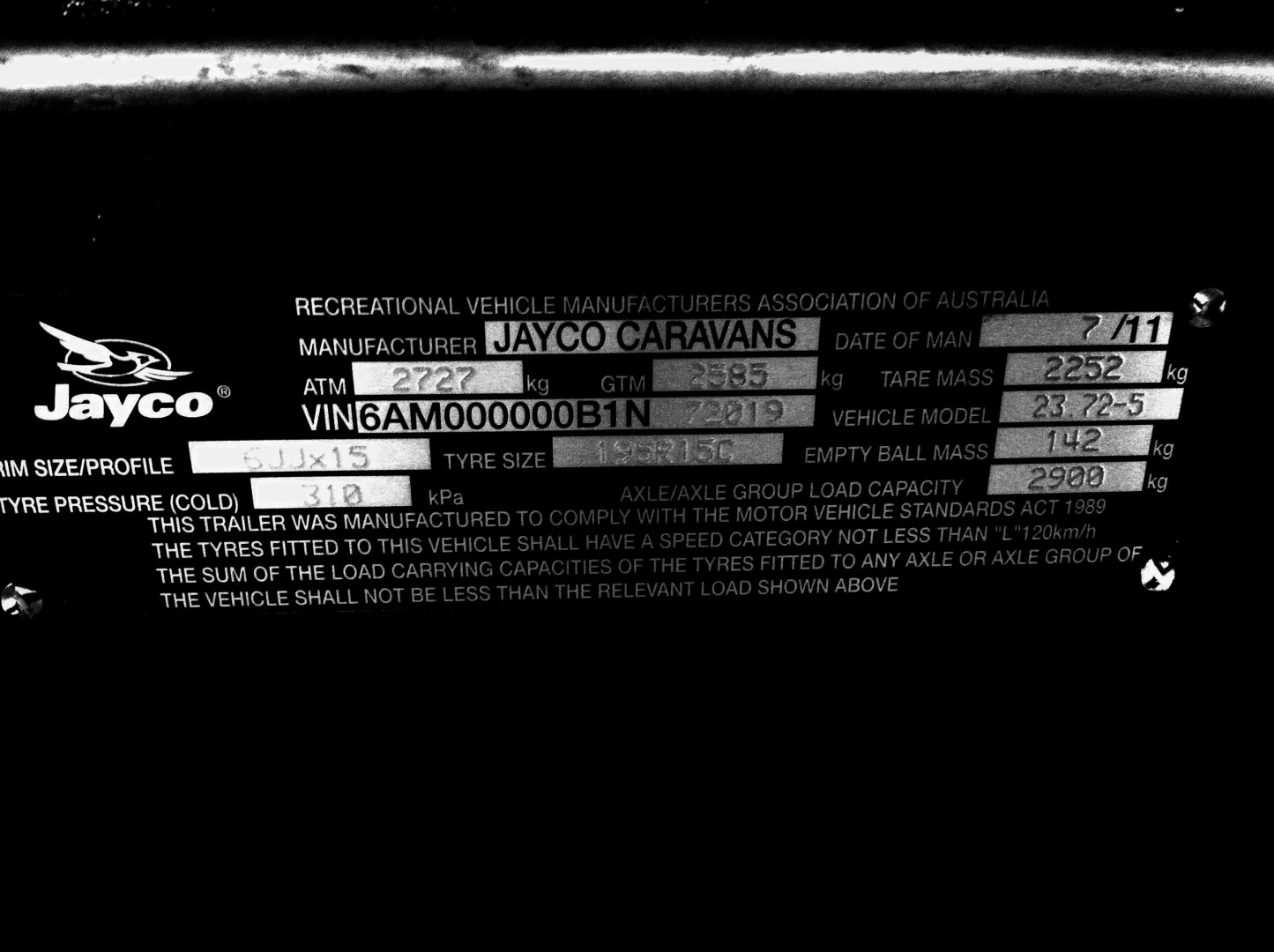

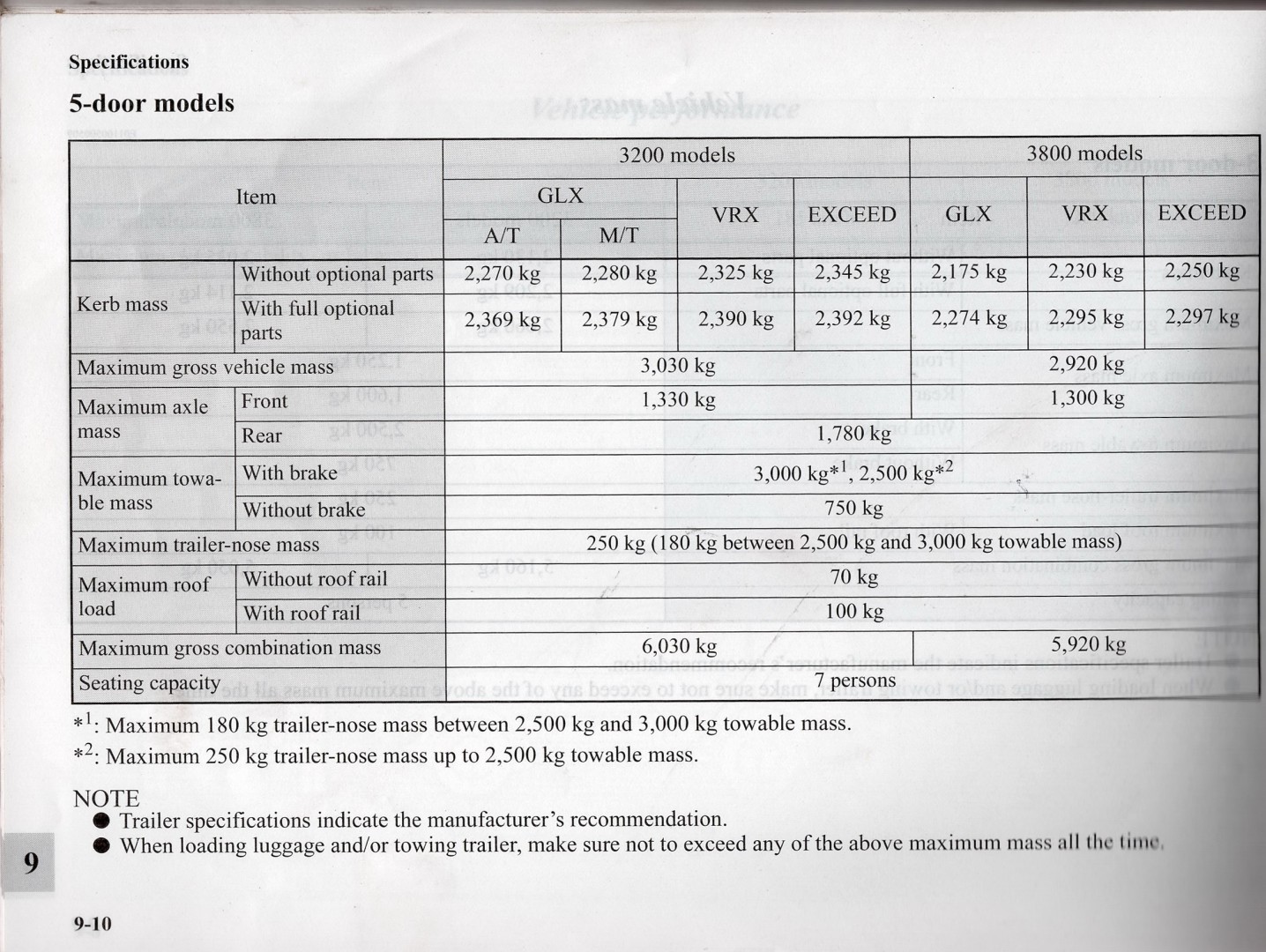

If van weighs 2700 kgs max allowed ball weight is 180 kgs so you have a major problem.
Even if van weight is reduced to 2500 kgs getting the ball weight back to 250 kgs will still be no easy job.

It will be very difficult to achieve the correct ball weight unfortunately, as AP's van has an empty ball weight of 142 kg.
Good luck Paul, and I hope you can sort out the issue.

Can you clarify please Bill, not sure what you mean by max ball of 180kg??
vince56 said
11:41 AM Aug 25, 2017
Sorry Bill, forget that, I just saw the spec sheet attached.

If you weighed it hitched, I think you have blown the vans GTM and ATM.
Actual ATM = GTM (axle load) + Tow Ball WT
3020 = 2700 + 320
Your max ATM is 2585
If unhitched, you have blown the vehicles GVM as well, as you need to add the tow ball weight to the vehicle mass.

ATM is 2727 kgs and GTM is 2585 kgs on compliance plate pictured.
Yes need to know if van was unhooked from tug when weighed ?
-- Edited by Bill B on Friday 25th of August 2017 03:18:46 PM
xman said
04:04 PM Aug 25, 2017
yep.., my bad, ATM is 2727 so we're approaching 300 kg's adrift

In that case AP, unfortunately, all of your weights are out. So, according to Mitsubishi your ball weight is too heavy for the vehicle, and according to your compliance plate, your van is nearly 300kg overloaded, and has over 100kg too much on the wheels.
Your maximum ATM is 2727kg, but actual weight is 3020 kg (2700 when hitched, plus the ball weight), your maximum GTM is 2585kg, but the actual weight on the wheels is 2700kg, and the max ball is 180 but is actually 320 kg.
I know you are probably well aware of that, so good luck getting your weights within the legal loadings allowed.
Sorry to do a Sybil Fawlty and "state the bleeding obvious", but if they do ever pull you over loaded as you were for this trip, you would have a problem, and probably not the ball weight!
