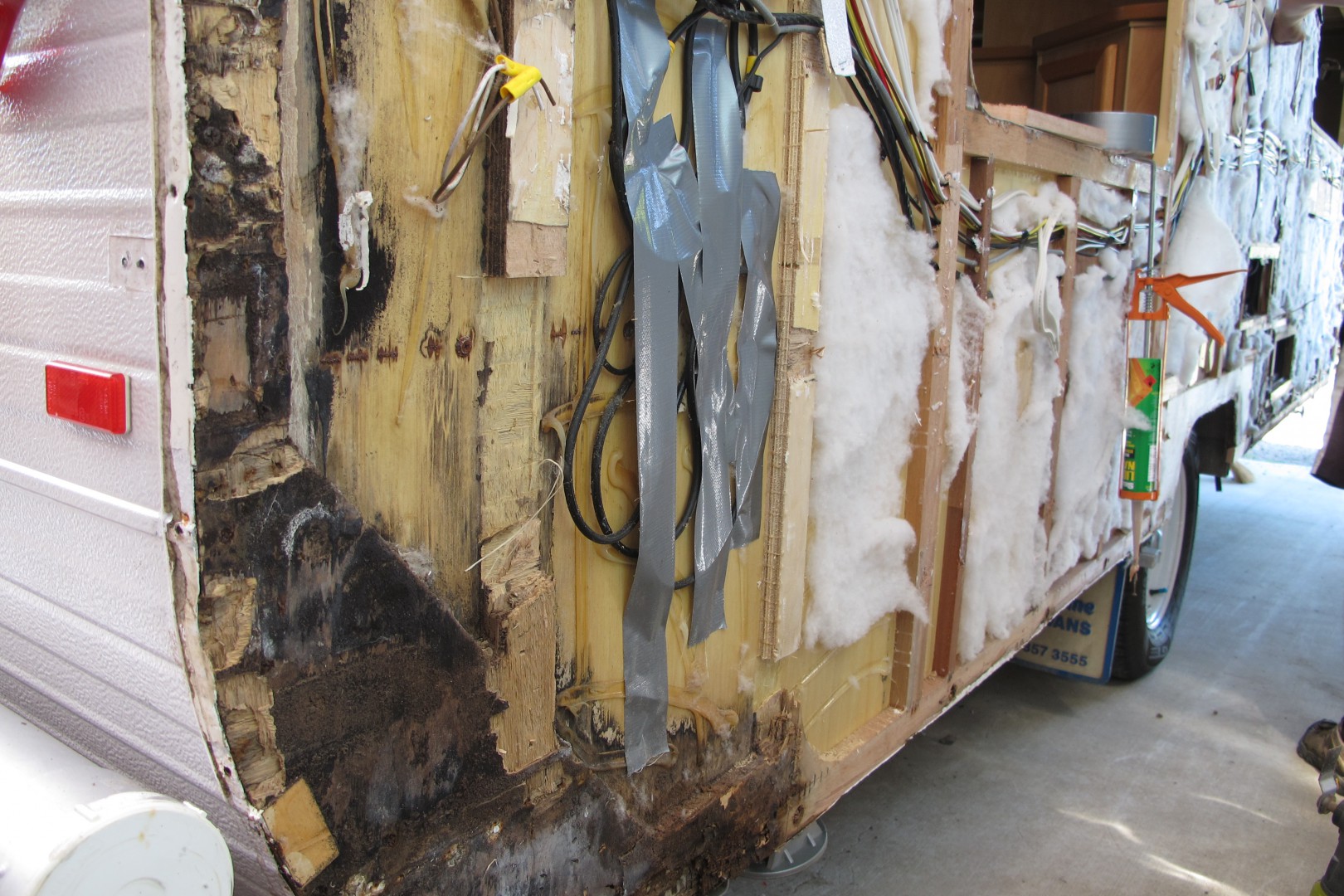

Here is a photo of our van when the repairer stripped the hail damaged cladding off.
Thanks mate appreciate your feedback,you photo just confirms my feelings about Supreme caravans. With the size of power point holes in my van I reckon I could use a shovel HA HA. Thanks once again

That black mould looks pretty nasty
Hi Jewel.
We spent a considerable amount of money repairing those darken spots, they are water damage.
To this point in time we thought our caravan was great. There was no way it was noticeable externally.
It was explained to us, that where ever there is opening for a vent water will get in over time.
The caravan was 5 years old when this was found while repairing the hail damage.
When we sold the caravan 2 years later, we showed the buyers the photos before and after the repairs and gave them the phone number of the repairer.
Sold the caravan with confidence of no come back, they were so happy, very excited.
