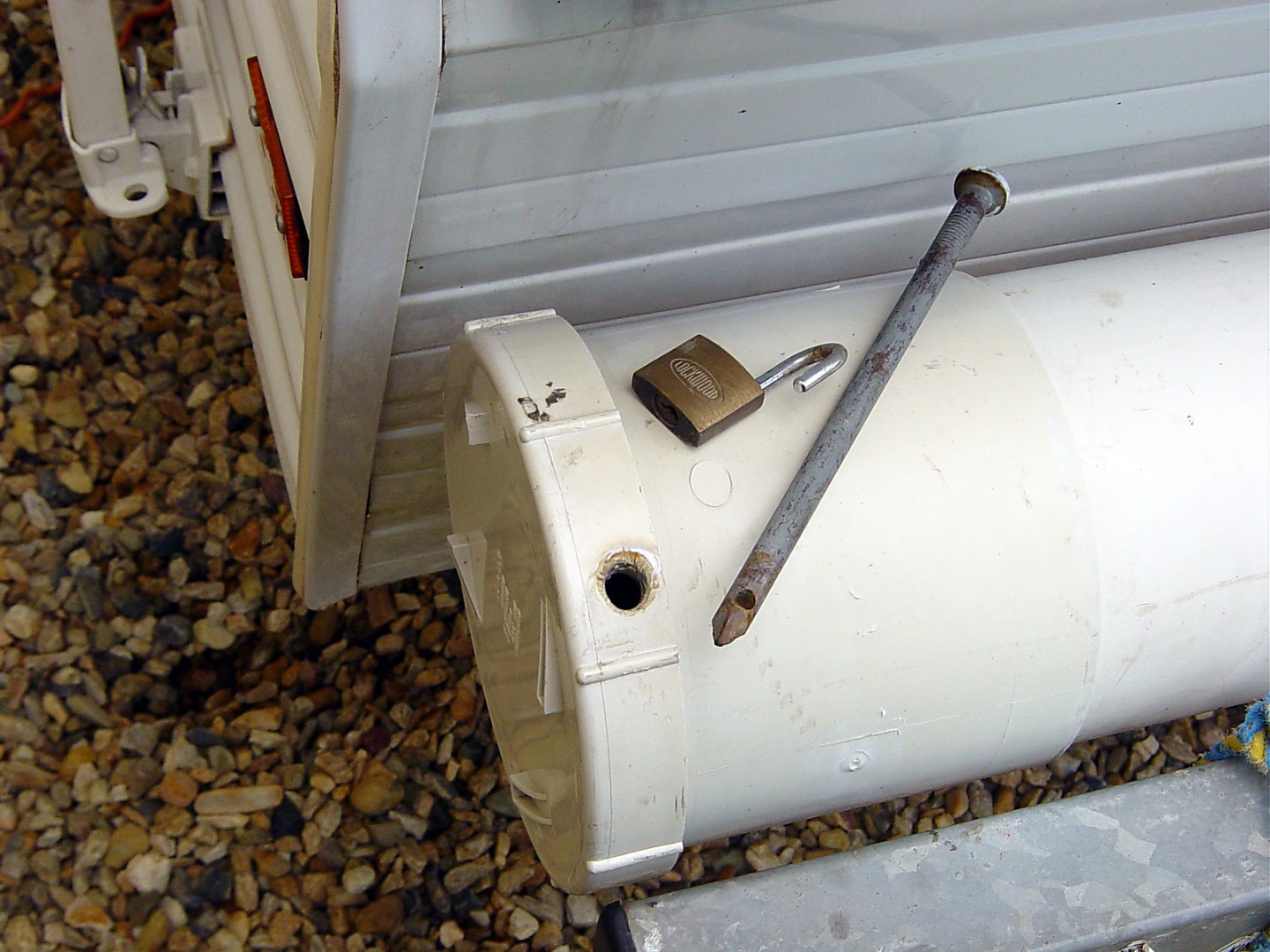

My lock comprises a large flat headed 'nail' about 1cm in diameter and about 15cm long that is inserted through the end cap & cut off with about 3cm protruding out of the suitably drilled tube.
I then drilled a hole through the end that protruded out of the conduit & used one of the common keyed small padlocks that I use in various locations around the van
eg.. Lock Gas bottle cover, lock the Engel to its tiedown in the back of the Tug & on the chain that secures my kayaks.
All such security only protects against the opportunist thief In the age of battery operated grinders very little is safe without expensive security devices.
ps. I made up a metal reinforcing insert for each end cap to prevent poles 'breaking out'. Just stuck them in place with silastic.
