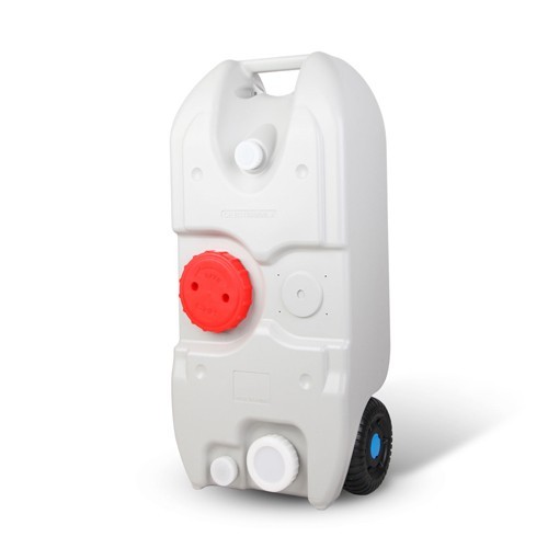

rayjudesmith said
05:11 PM Jul 26, 2017
You can get a portable 20/40L tank on wheels. Much easier to pull that to the dump point than have to drive the van to the dump point and empty. You also don't get a build up of odours etc if you are unable to empty as often as needed. We have a portable one and it is great.

PeterInSa said
05:37 PM Jul 26, 2017
Re (You can get a portable 20/40L tank on wheels. Much easier to pull that to the dump point than have to drive the van to the dump point and empty. You also don't get a build up of odours etc if you are unable to empty as often as needed.) Agree
To me a built in unit is great for a Motorhome or Campervan, you drive the RV to the dump point, but with a caravan... hook up and drive and then return to the same site?? with a Tote Tank you load into the tug and empty whether its 400m away or 4Km.
The CMCA now accepts tote tanks (with valving to prevent spills) at their RV member only sites.
I think a tote Tank gives you more free/low cost camping options, the challenge is where to store it when not required.

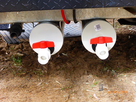

Big Mal said
07:58 PM Jul 26, 2017
If you look at various free camp listings they go on about contain when in reality a lot of them don't require it, the tree huggers are pushing the issue, just a bit of common sense is required but since a lot don't have any the requirement for having a tank will increase.
I have made a twin 150mm PVC tube tank, it holds 90lts, fits behind the wheels and by turning the drain tap off it becomes a holding tank, the main thing is it can be cleaned by removing the end cap and hosing out all the goobers that collect, so it doesn't pong like the converted water tanks that others use.
Some places like winery's you need a grey water tank just because of the car park type location and in reality the 20lt bucket is a pain, they overflow, and you hae to carry the damn things......
A long hose to a tree is no drama and the grey water is not going to kill anyone, hell my yard for over 25 yrs was green as that was the only water it could get, no town water just tanks..

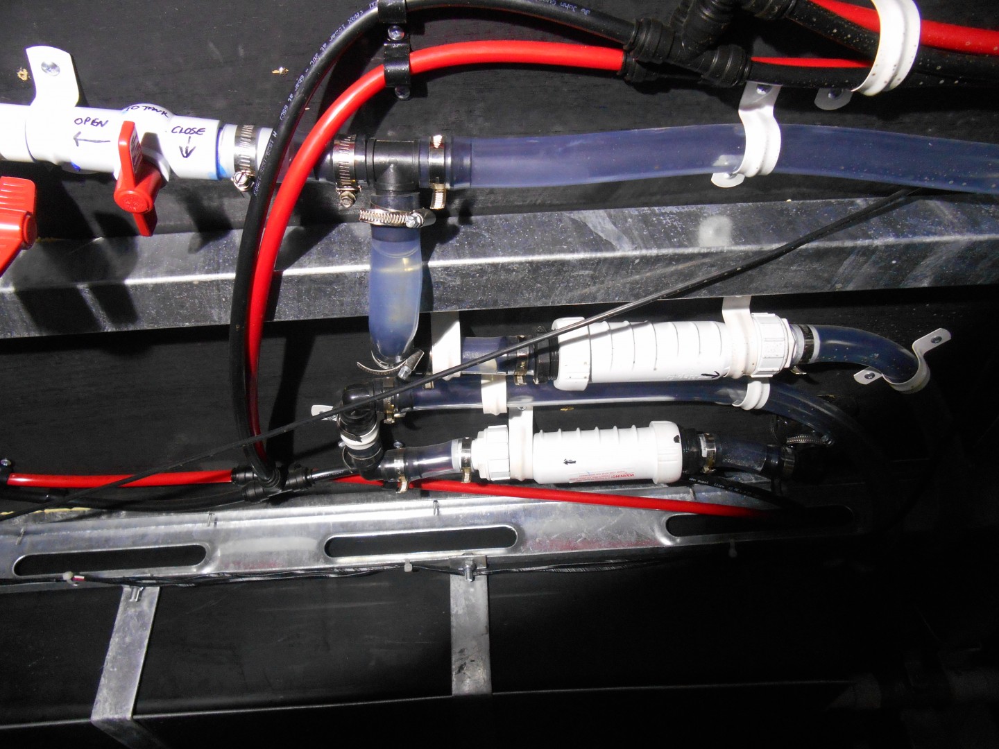

Hey Jim said
09:39 PM Jul 26, 2017
Skoobiedoo wrote:
Hi all. We are in process of purchasing a new van (our first) and chose not to have a grey water tank included. This is because most of our caravan buddies say not necessary use a bucket for grey water containment. We intend to do a lot of free camping where possible. i have since read in recent article that many free camp sites, especially the newer ones now insist on vans with self containment only. Has anyone come across this. I guess we should get back to the manufacturer and insist on inclusion of a grey water tank? Your views would Be appreciated. Thanks. Yours in caravanning, Skoobiedoo.
Hi Skoobiedoo,
If the funds are there Do it.
Factory fitted you get 2 Hypo one way flap valves. Stops the smells flowing back into the van from body hair etc.
Jayco did ours on the assembly line. Still stuffed that job up as well.
Inverted the Hypo Valves as well.
Had to email them the fitting instructions on how to install.
Real bright Eh. Quality control. Drrrrrrrrr not.
Cost us $600 extra fitted. Cost them a whole lot more. Dick Heads.
There after I in stalled x 2 bypass ball valves so I can hold or let the trees have some.
You can see their clear flattened hoses out of the factory, as well in these photos. That's standard issue by their standards.
I ended up doing / using proper reinforced hose the correct way, As their agent would not.
Purchased a spare toilet toilet cassette than can collect grey water or go longer before dump points. Black or grey, full it will go in my ute.
Eaglemax said
09:45 PM Jul 26, 2017
Hi Big Mal
Great idea but how many can carry 90 kg of grey water plus weight of two six inch pipes and caps? Plus good water. Batteries etc. Gee I'd have to leave mi undies at home :)
Big Mal said
04:01 AM Jul 27, 2017
Eaglemax, who runs around with a grey water tank full, when I do it doesn't go very far and besides one water tank would be empty anyway so no increase in weight........it's never long till I find a needy tree.....................................I rarely stay long at the places that demand holding everything they are usually a bit Nimby for my liking....Have contained and evry evening did a bucket walk to some nearby tree's as dropping on the ground would just make a bog hole no matter how long the hose.
If just got a sink to drain then a bucket is okay.
My tank would cost about $200 to make......my other van I made a 40lt tank......the current rig is all geared up to miss the caravan parks most of the time .

JohnR said
08:30 PM Jul 27, 2017
Big Mal
You tell us that your dual 150 ml pvc sewerage grade tanks (pipes) hold 90ltres.
Can you tell me what length they are??
We have 150 x 85 that hold 32.5 litres x 2 giving 65 litres in total.
JohnR

07:02 PM Jul 28, 2017
A 150 mm pipe will have a capacity of approximately 16.2860 litres per meter.
JohnR said
08:10 PM Jul 28, 2017
Peter D
Sorry my typing.
The 150 ml sewerage grade x 2 pipes are 185cm holding 32.5litres each giving 65 litres in total.
Just check Mr Google to see what length/width pipes needed to hold 90 litres.
I think I have thrown these pics up several times before.
However, I still have people coming over asking about the set up and after 3 yrs + they are working to perfection with only the caps being replaced due to failing seals. I have to laugh when I see this convoluted set ups and sealed holding tanks people brag about.
If you cannot access to clean and allow to air they will HOLD the smell.
Plastic fuel tanks fit up well . 60 or so litres ..

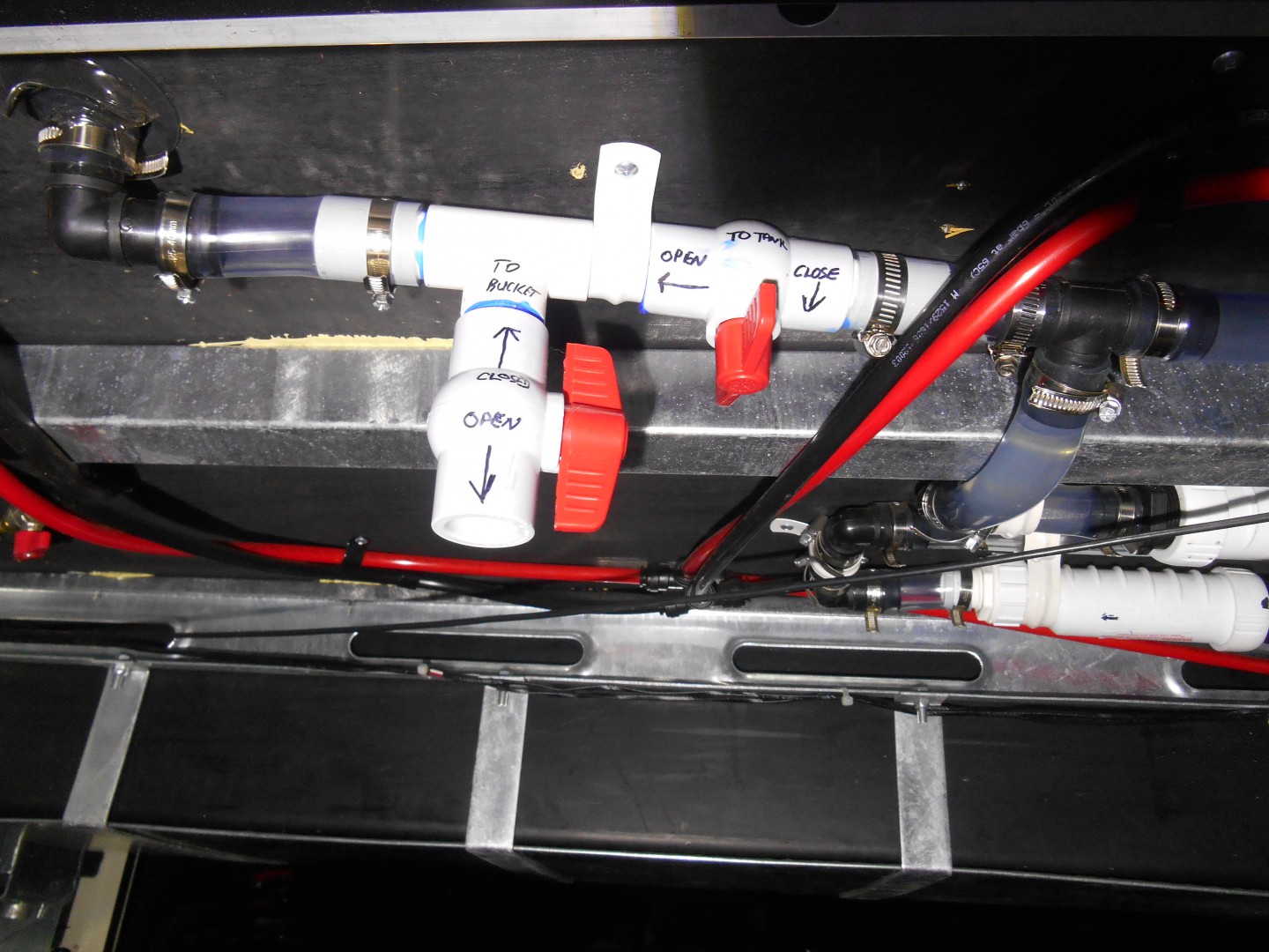

Hey Jim said
09:27 PM Jul 29, 2017
Hi John R,
Yes you are 100% on the smell. I saw your setup when you posted on Grey water tankage. We had our van signed sealed and Stuffed up from delivery.
I got the sh...ts when I climbed below on my garage creaper. Even with my 2 x Hypo valves fitted I crossed my T's & X my I's.
I installed 2 x 65mm screw bungs, one high on the inlet end and the other on the outlet low end, to allow my gurnie to flush the 85lt tank.
If I had had my time over. I would have done exactly / copied yours, doing the total job myself and saved $$$.I live and learn with our first van.
Iana I think, did copy yours as well. I like it so much . I may end up starting over. So simple, Practical. And best of all Its plumbed and done right.Plus I can put my water tanks back in the correct position.
If only Jayco could pull their fingers out Eh!!!!!!!
Regards Jim
JohnR
Hi John R,
Regards Jim
