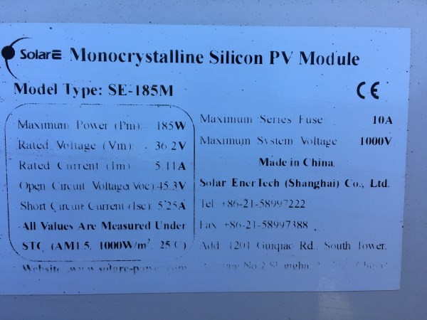

This is all I could find when I Googled it , only 175 w not 185 w
175W Solar Enertech 24V Monocrystalline Solar Module
Used modules - been in service for only 6 years - Limited Stock
Original specifications are as follows:
Model: SE-175M Max Peak Power (MPP): 175 Watts Voltage @ MPP: 36.0 V Current @ MPP: 4.86 A Open Circuit Voltage: 44.8 V Short Circuit Current: 5.17 A Dimensions: 1580 x 808 x 46mm Weight: 16.0 kg
-- Edited by goldcoaster on Saturday 8th of July 2017 01:13:24 PM

goldcoaster said
07:11 AM Jul 9, 2017
Thanks Jaahn,
It will be a 12v system. So how do I calculate the size of mppt to the amount of watts.
Mick
Jaahn said
08:34 AM Jul 9, 2017
goldcoaster wrote:
Thanks Jaahn, It will be a 12v system. So how do I calculate the size of mppt to the amount of watts. Cheers Mick
Hi Mick
Just look at the specs for the different units and use the max watts for your panels.
Because the MPPT controller takes higher voltage from the panels and converts it to lower voltage for the batteries, the battery current is increased proportionally, so you must be careful. But the maximum wattage of the panels always remains the same.
Here are some specs taken from an Ebay add;
Item
Tracer 1210A
Tracer 2210A
Tracer 3210A
Tracer 4210A
Item Model 1210 2210 3210 4210
Max. PV input power
130W/12V 260W/24V
260W/12V 520W/24V
390W/12V 800W/24V
520W/12V 1040W/24V
So you have 2x 185 W = 370 Watts max panel power.
so model 3210 should be OK at 12V nominal battery voltage.
Search for Tracer solar controller and look at the units available. There are several model available now. You can also get a remote meter to fit to it so you can see what is happening to your system when the controller is hidden down near the battery.
Cheers Jaahn
PS If the panels are flat mounted on the roof then the wattage can be a "bit"over as the panel output is always lower and the controller would self-limit the current in the unlikely event of it ever being too high.
-- Edited by Jaahn on Sunday 9th of July 2017 01:13:55 PM
kezngaz said
10:21 AM Jul 9, 2017
Would the controller have to be able to accept 36.2 v
Or 45.3v, just for furure reference?
Thanks.
Kezngaz.
Jaahn said
10:56 AM Jul 9, 2017
kezngaz wrote:
Would the controller have to be able to accept 36.2 v Or 45.3v, just for furure reference? Thanks. Kezngaz.
Hi Kezngaz
The controller must be able to accept at least the Maximum panel voltage. But better ones and MPPT good controllers are usually rated at much higher voltages.
EG From the same Tracer unit the specs are 100V. So you can even use the panels in series. Which may have some advantages, perhaps ? However not to my liking with these 24V type panels on a mobile home/caravan roof. 90 volts DC is too high for me !
Max VOC ---- 100V
Cheers Jaahn
-- Edited by Jaahn on Sunday 9th of July 2017 10:59:45 AM
kezngaz said
06:14 PM Jul 9, 2017
Sorry jaahn.
Given the example above, which reading is the one your on about?
Kezngaz.

goldcoaster said
06:38 AM Jul 10, 2017
Jaahn ,
If I read your post right , you wouldn't use these panels.As I got these panels free , 6 of them , should I put them on my house instead of motorhome and buy other panels . My last motorhome had 450w supplying 3 x 120ah Batteries , never had a problem running out of power , fridge/freezer 190ltr 12v/240 , 60ltr Engle, lights, TV's and other things so I would like the same in the new motorhome.
Mick
Jaahn said
09:15 AM Jul 10, 2017
goldcoaster wrote:
Jaahn , If I read your post right , you wouldn't use these panels. As I got these panels free , 6 of them , should I put them on my house instead of motorhome and buy other panels . My last motorhome had 450w supplying 3 x 120ah Batteries , never had a problem running out of power , fridge/freezer 190ltr 12v/240 , 60ltr Engle, lights, TV's and other things so I would like the same in the new motorhome. Cheers Mick
Mick,
I see that I should not have said more than the basic answer ??
YES use those panels. You said you wanted two, that is 370 watts. Wire them in parallel into, say a Tracer 3210 and all will be well. That setup will work well for you IMHO. If you wanted to use more panels, put them in parallel, but you will need a bigger rating controller to match the watts at 12V.
Sorry jaahn. Given the example above, which reading is the one your on about? Kezngaz
________________________________________
Kezngaz,
The reading you asked about is the OCV, the Open Circuit Voltage, 45.3V for this panel. That is the highest voltage that the panel can reach when it is in full sun and not producing current. So a controller must be able to take that voltage so it does not burn out. The Tracer in my example will take up to 100 volts so it is quite safe to use.
Jaahn
-- Edited by Jaahn on Monday 10th of July 2017 09:29:40 AM

goldcoaster said
11:56 AM Jul 10, 2017
Thanks again Jaahn.
Can I pick your brains a bit more.
Parallel is pos to pos , neg to neg . I hope I got that right.
Once the panels are joined in parallel , does the wire down to the MPPT need to be heavy duty. Recommendations on size .
Mick

Jaahn said
06:55 PM Jul 10, 2017
goldcoaster wrote:
Thanks again Jaahn.
Cheers Mick
Hi Mick
Yes parallel is as you say pos to pos , neg to neg panel connections.
The wire down to the regulator needs to be a good big size so little power is lost. Say 10AWG would be OK and good clamp connectors where you joint the panels to it not rubbish. Bigger is OK. Note there is confusion about wire sizes so do your home work when you buy to ensure you get what you asked for.
The wire from the regulator to the battery needs to be twice as thick copper. Say 6 AWG if short. Bigger is OK.
Jaahn
-- Edited by Jaahn on Monday 10th of July 2017 09:40:12 PM

Can I use this panel on a Motorhome or caravan , came off my son in laws roof. If so what reg would be needed for 2 of them.
Model: SE-175M
Weight: 16.0 kg
Mick
Hi Mick
Thanks.
Kezngaz.
Hi Kezngaz
Max VOC ---- 100V
Cheers Jaahn
Kezngaz.

Mick,

Kezngaz wrote
Sorry jaahn.
Kezngaz
Kezngaz,
Jaahn
