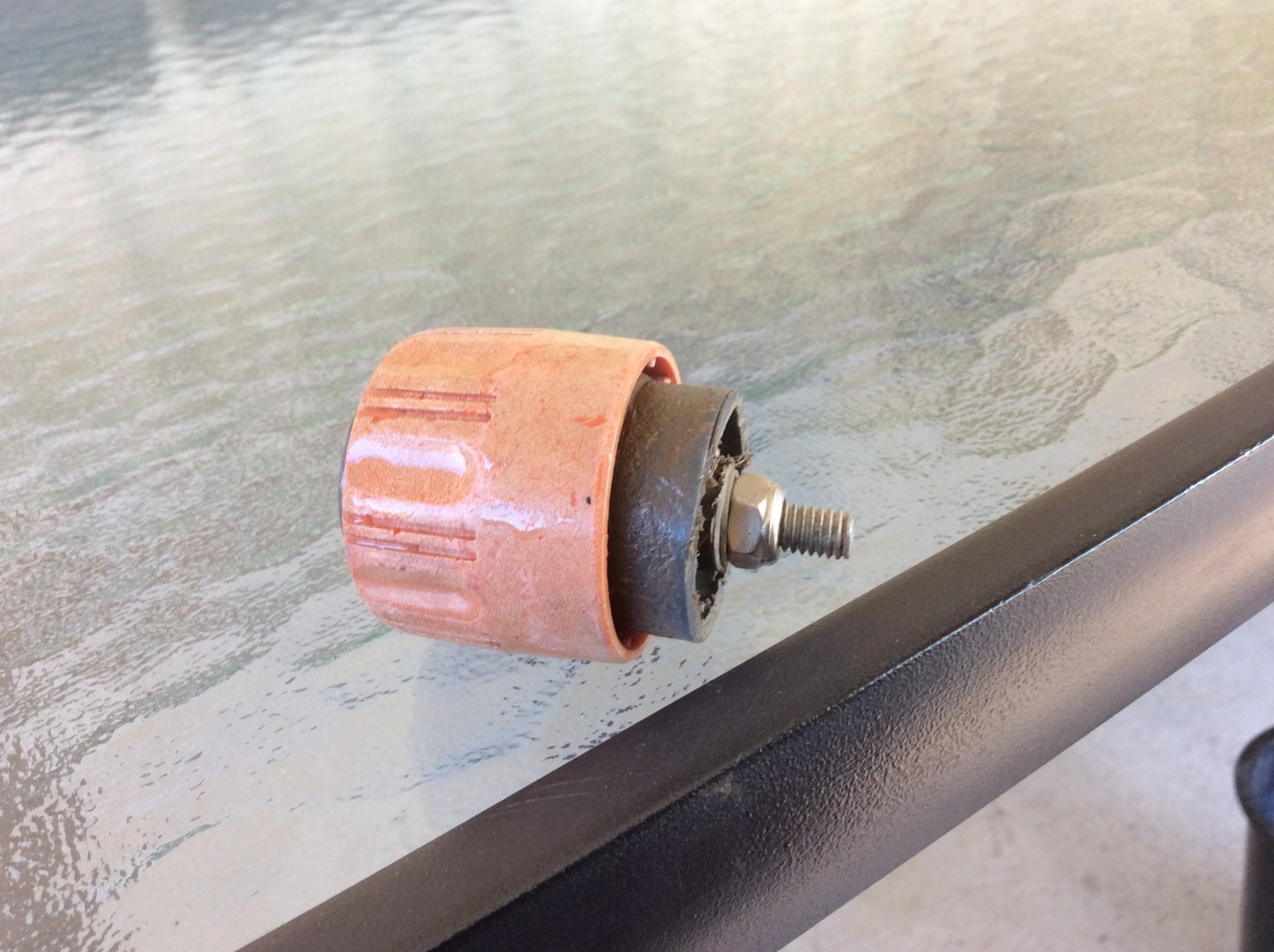

Install an isolating ball valve in between your tank and if possible, within half a meter of your pump, then install a T piece after the valve, then install a male snap on hose fitting in the T piece. Make up a blank fitting out of a female snap on hose fitting which will be used to seal off the male fitting that you have just installed in your T piece. Now with the valve in the open position you can use the water from your tank as normal, turn the valve off, remove the blank and install a short bit of hose in its place, you can now suck out of that bucket etc which you have filled up from the creek and enjoy a wonderfull long shower Without using your precious water. Hope this is hel
Yes Mike, I understand your concerns, but there are always hazards to be considered no matter what we do. I like to keep things as simple as possible especially if only staying for one night. A simple flush of the lines would probably use about half a lt of water considering the relatively short pipelines in your van and you don't have to carry all that extra stuff with you not to mention setting up, especially for a one night stand.

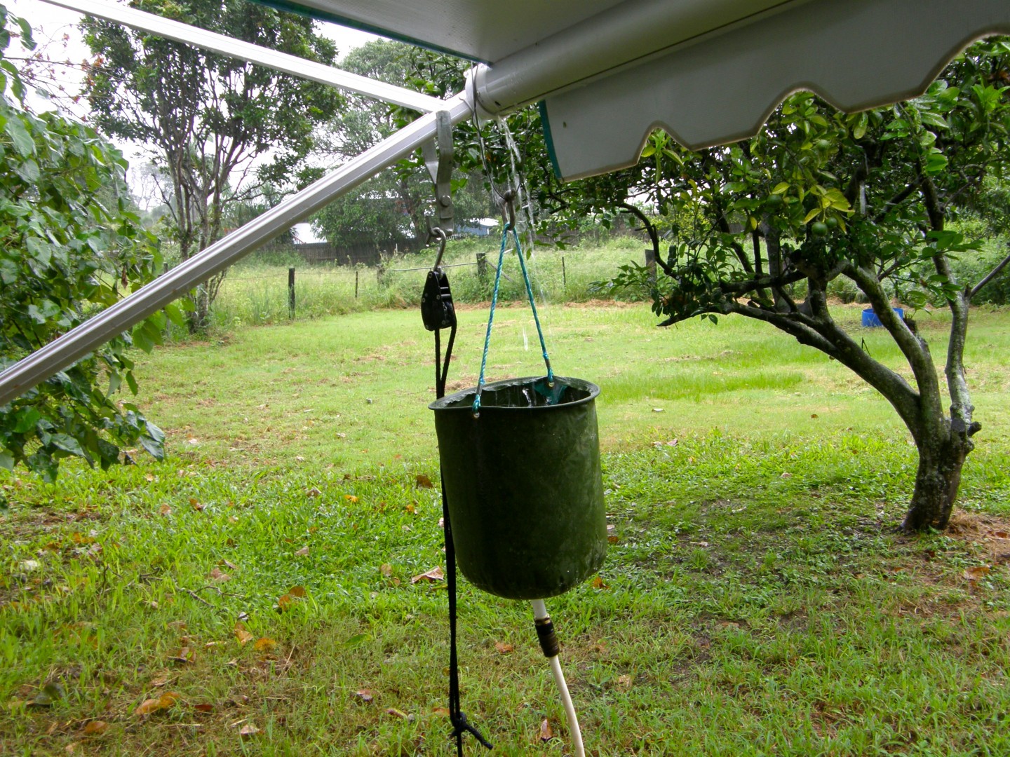

Just use one of these
https://www.anacondastores.com/camping-hiking/camping-toilets-showers/toilet-chemicals-accessories/oztrail-canvas-shower-bucket/p/90035739?gclid=Cj0KEQjwv_fKBRCG8a3ao-OQuZ8BEiQAvpHp6B7GX4S85DcGarP3pW5LNprn93-tK8Z6q1j1idJO1tEaAlWO8P8HAQ
oldbloke said
07:30 PM Jul 6, 2017
Sorry, link did not work.
Just hang the Oztrail Canvas Shower Bucket anywhere, fill it with warm water & you'll be delighted with the slice of luxury it provides!
Features:
20 litre capacity - enough for a good wash
Turn the brass shower rose on & off with a twist
Collapses & folds away
Easy to carry & store
100% waterproof/leakproof

Used the army version of these many times. Yes they certainly work well & economically too.

Peter , I also use one of these but I half fill with water and top up with boiled water from kettle - I think they are a bit cheeky in stating inbuilt thermometer - It is only a guide chart printed on bag which is pretty iffy anyways.

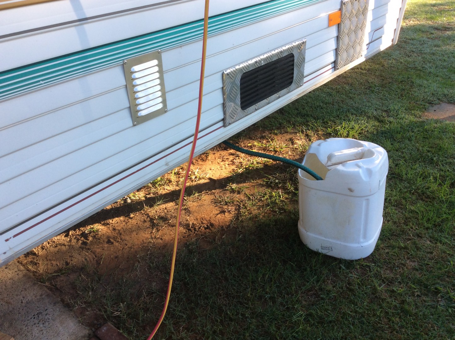

We installed a surflo pressure pump under the rear of our van and using a simple connector and short section of hose are now able to heat water over a fire in a drum to 45 degs and run the water through the pump and then through a tee piece up the cold water side of the shower. Being a pressure pump the cold tap in the shower starts and stops the pump. I have installed one way valves to prevent water going back into our drinking water tanks and also to prevent water being pumped out when using our drinking water to shower. To operate all we do is turn off the van pump. I also installed a separate switch for the second pump and a stone guard to prevent external damage. You certainly don't have to be quite as fugal as when using your drinking water.
female fitting blanked off
This one is my style. We can both get a shower out of it half filled.
