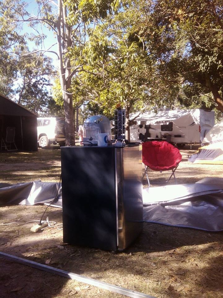

DeBe said
09:38 PM Jul 1, 2017
Here you go camping north of Cairns in a tent no problems. Fridge & Coffee machine.
-- Edited by DeBe on Saturday 1st of July 2017 09:40:20 PM
Yep, buy a 240v jug, toaster, a couple of lights, heater if required & take a battery charger to run your aux battery for your fridge.
Just do it safely.
Just do it safely.
Warren
