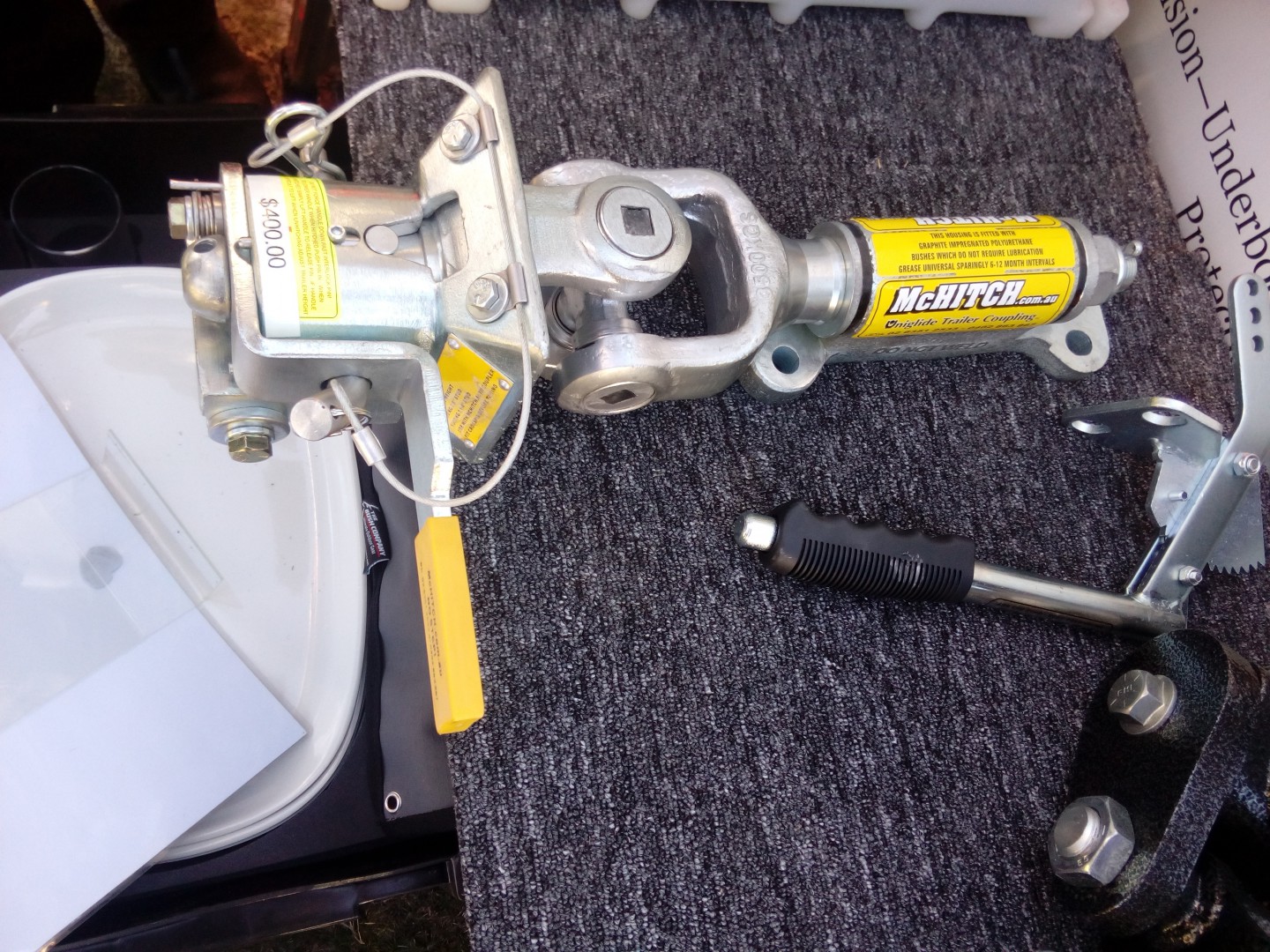

We have a McHitch on our camper and it has an added bonus. Although we like to trust people and fellow campers there are always people who dont live by any code. With the McHitch it is like a universal joint with a coupling and you are able to pull the coupling back and put your safety chains through the back of the coupling, this will make the hitch section which you connect to the car point at a 90 degree angle and impossible to hitch on a car, and then you can use a padlock to secure the coupling in that position, hope that all makes sense, I can post a picture if you are interested in going that way.
