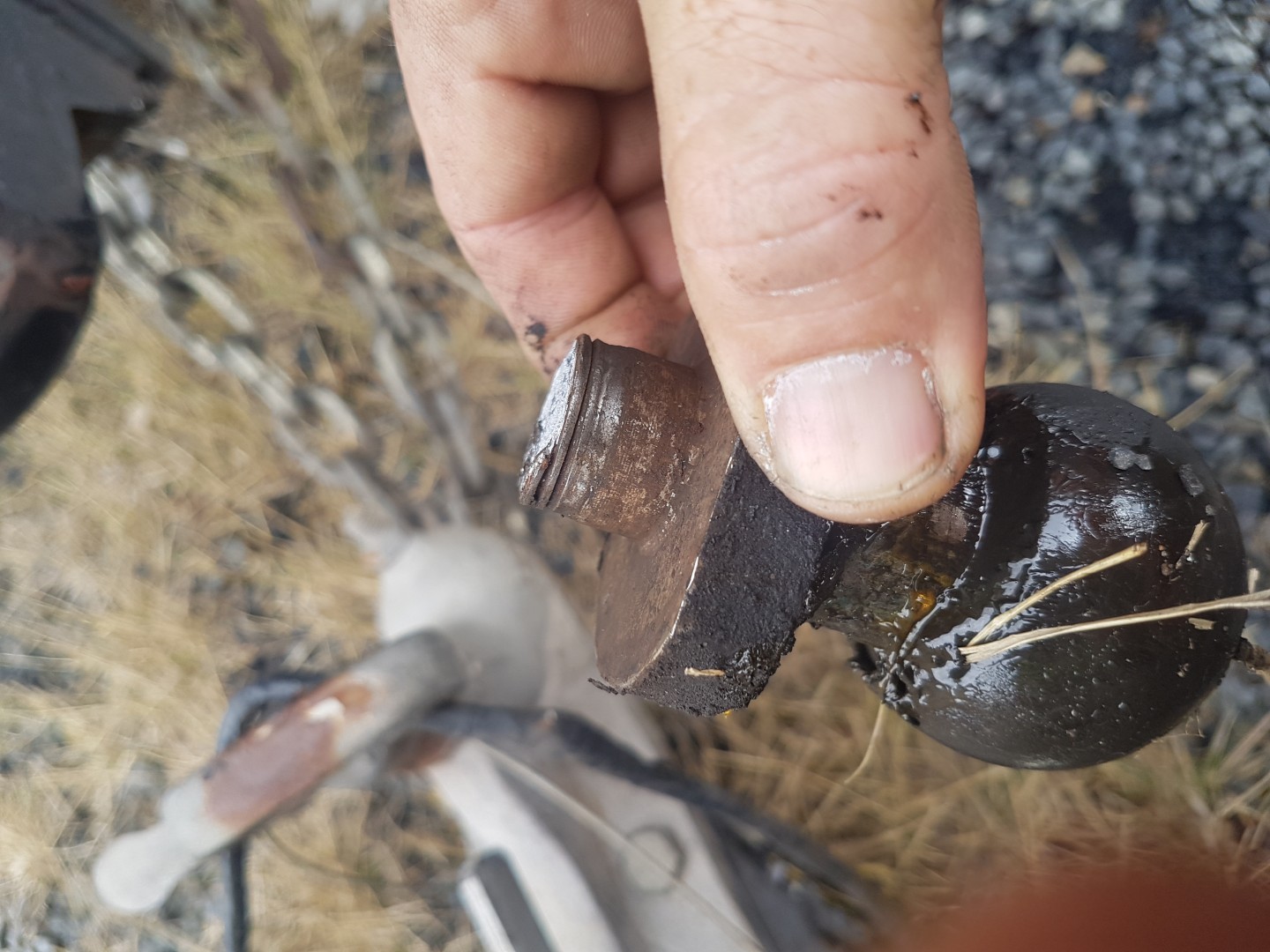

Son of mine just snapped a towball on his light truck towing a 3000kg twin axle trailer. Luckily it happened as he was slowing from 100 down to 70 coming in to Warra out west of Dalby. The Warrego highway out that way is all up and down and broken drawbars on trailers/vans are not uncommon.
Happened with a sudden bang and then the trailer swaying side to side almost tipping on each sway. Fortunately it seems that the safety chains prevented the drawbar digging into the road which probably would have snapped the chain, however after he stopped he found the drawbar was touching the ground, maybe the chains stretched?
I am advised by an engineer that if you ever have tow ball come loose then replace the the tow ball. They will eventually break because the crystallization has begun.

I had a similar thing happen to me many moons back, Denis. I had only just got my then Avan Camper Trailer and heading off on my first weekend breakdown trip when 'BANG'. Now only my dry cleaner and myself knew how I reacted. On getting out of the tug I noticed camper sitting on chains and tow ball still attached to coupling on camper but not tug. The thread section had rusted through unknowns to me and snapped. I was paranoid of the camper coming off for many moons after that.
My fault. At the time and for many moons had car parked with Base Strait sea air blowing on back of tug. Big lesson there. Change tow ball on regular basis. I am currently thinking of changing mine over now after nearly 3 years on tug and around water a lot. I have checked it every 6 months or so though. It will get changed before I leave Townsville.

blaze said
01:19 PM Jun 18, 2017
The base of the ball sugest to me that its been loose, they should have clean mating surfaces.

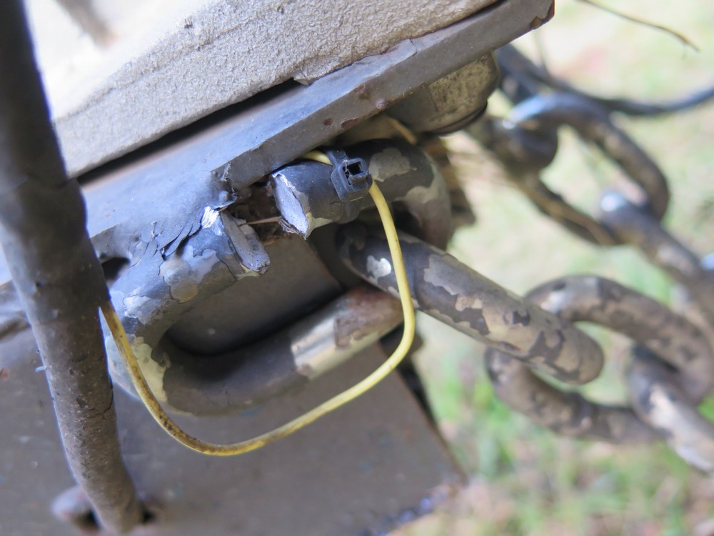

hako said
05:51 PM Jun 18, 2017
You're correct blaze, the nut was tightened with a long breaker bar so was initially tight so the nut had either loosened or the bolt part of the ball stretched...and yes, lack of maintenance. I just went out and had a closer look and found one of the chains had snapped but not totally - see pic. Also another pic of the setup as it ended on the road. It's all a bit sobering to say the least.
