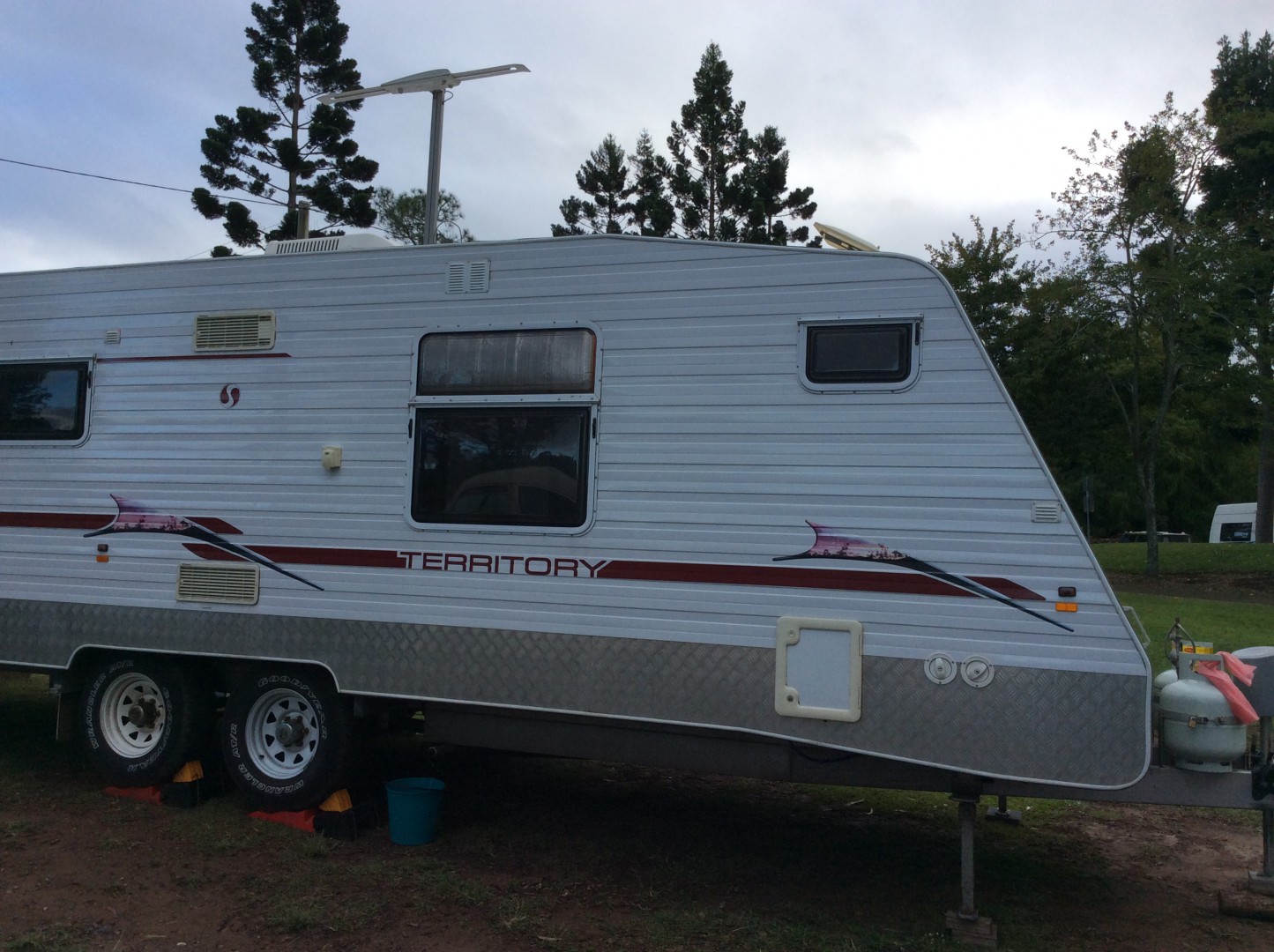

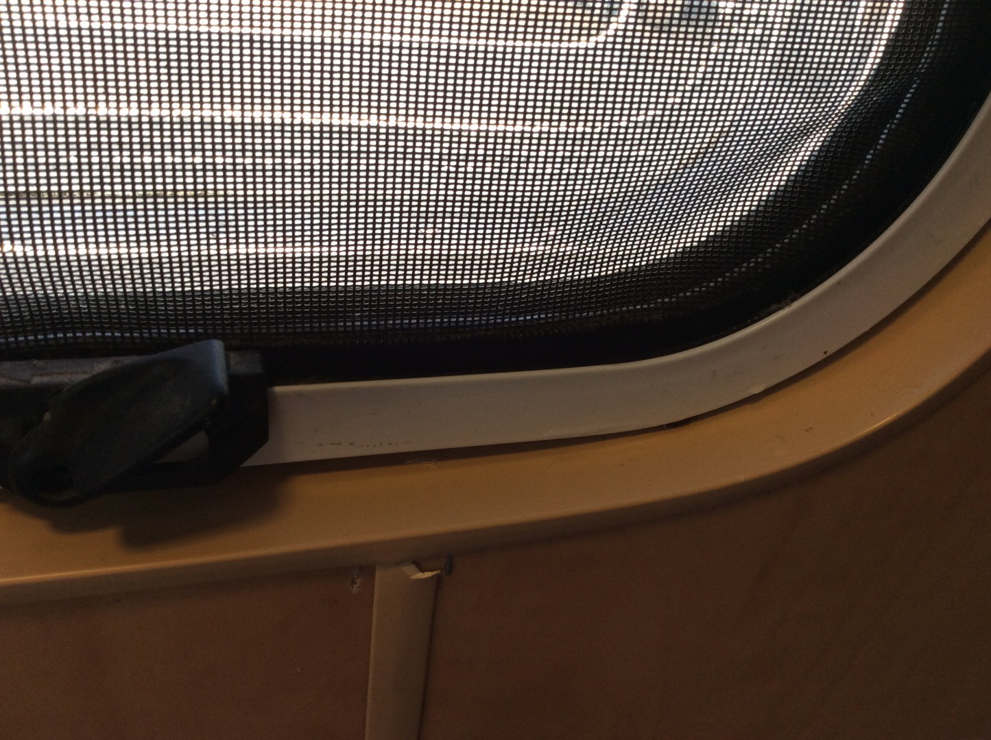

hello everyone, has anyone had a similar problem with a leaking window. It is In the lefthand corner facing the van On the outside. It is only a small amount. Inside: it comes through on that littlewhat u could loosely call the window sill and the aluminium window frame. Strop thinks it is not the roof because when he cleaned that it did not leak but when he cleaned the side of the van water came in that corner. Was also wondering does The rubber around the window ever need replacing.
