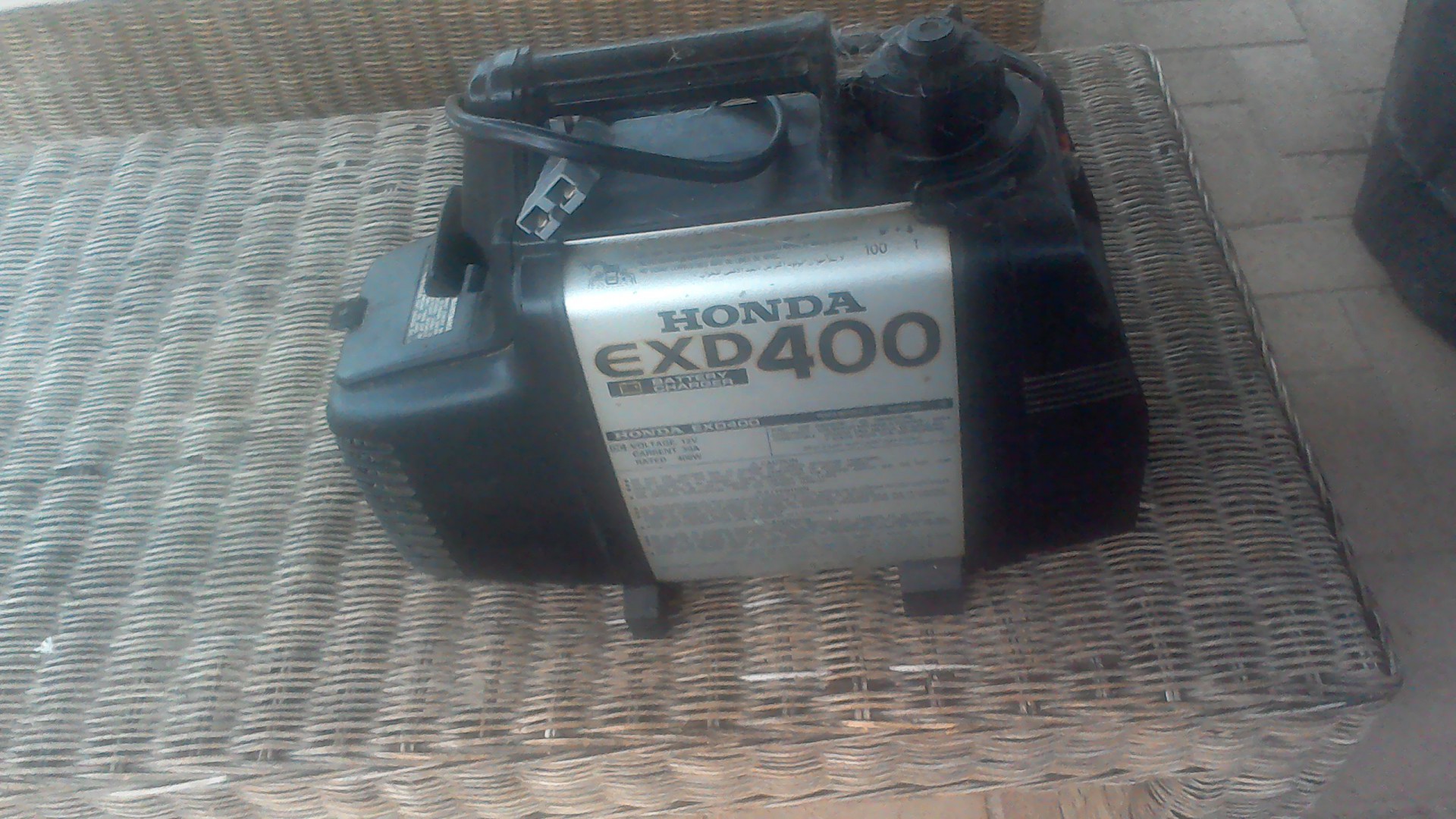

Water taken care of I next turned my attention to power. I bought two 100 amp Marshal, wet, deep cycles. AGMs weren't available then or if they were I'd ever heard of them; well, this was my first foray into 'civilised' camping. For the batteries I made an angle iron frame to house them longitudinally, with handles either end and in the midlle I fashioned a plate to take two, two piece nylon bushes I turned up on the lathe. The bushes were insulators I used for connecting the batteries to the charger.
My first choice for charging were solar panels, but at $1500 back then, they were prohibitively expensive. Instead, I sent off for a Honda EXD battery charger, in essence a 12 volt generator, which, at $900 wasn't too cheap either, but I saw better value in the Honda, if not in monetry terms then certainly in output: 15 or 30 amps of dumb charging muscle.
The EXD was a 50cc two stroke with an alternator built onto the end of the cranshaft and packaged inside a neat black/silver plastic box. The tank held 0.8 litres of premixed fuel which lasted for two hours, 100/1 mixture so pretty clean as far as dirty goes.. Smart it wasn't, I had to keep an eye on the voltmeter I stuck together for this purpose: a $10 multimeter with two banana clips soldered onto the flying leads of a cigarette lighter plug which plugged into any handy socket. Once the batteries reached 14.4 volts, the Honda had to be turned off, if not, two very well done batteries.
The Honda served us for many years all through WA, QLD, NT and SA. I still have it, 19 years later, still working, in perfect condition and still in use up to a few years ago, best $900 I ever spent. Just sits in the shed now, I start it up once in a while just for old times sake. When I'm lowered into the ground the EXD will be beside me.

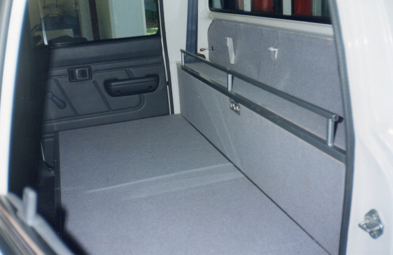

Not a lot to do on the Hilux, just removed the second seat and made up a shelf to take the fridge and a plastic container next to it for odds and sods. fitted it with a couple of cigarette lighter sockets and a skinny shelf up top for cups, coffee, sugar and one of those 12 volt kettles, you know the ones, useless, hopeless, dangerous and so on. I've been using these kettles since the 70s, never had a problem and I find they are excellent, just switch on 15 - 20 minutes before you intend to stop for a cuppa. No need to light a fire, hook up a gas stove and so on, much, much easier. And would you believe it, after 40+ years of using these kettles I still haven't been scalded to death - must just be lucky I guess..
I fitted a fuel filter from an earlier model Hilux and a foam air filter. The original fuel filters were $40 or so, whereas the earlier ones were only a few bucks. I also designed and fitted a simple dual battery system with parts from Dick Smith/Tandy, used this system for the next 5 or so years without problems.
I bought a second hand canopy, minus the rear window glass for a couple of hundred bucks, replaced the glass, fitted the canopy to the tub and made up some short steel shelves for either side of the tub. At the front on the sides I mounted two diesel jerries on the right and two water jerries on the left. To save manhandling the jerries all the time I bought a jiggler and ran it to the filler whenever we got low on fuel. Similarly, I machined out the centre of the water jerry cap and fitted a caravan pump tap with a short extension hose on the bottom to reach the bottom of the jerry. Both of these worked great, never once did I have to remove the jerries. Tobe the navigator wasn't allowed in a lot of parks so I fitted fans by the canopy windows to create a cross breeze and stuck his bed on the top shelf. We then parked just outside the park, stuck Tobe in the back with the fans on and a bowl of water and hiked in.

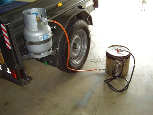

I made up some bracketry for a gas bottle and mounted that at the rear right. The stove sat on the right side of the tailgate so all that was needed was to slide the 2 burner out onto the tailgate and attach the hose to the bottle.

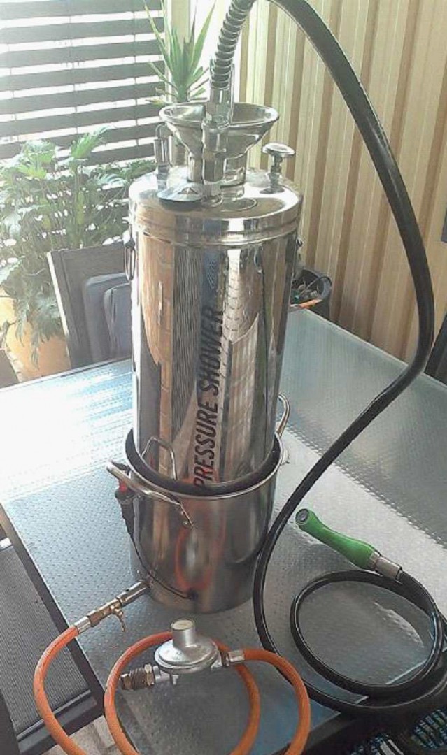

I can't abide going to bed dirty, likewise I can't abide by cold showers so we bought a gas heater from the camping store, ha,ha, ha, what a pile of rubbish. Water had to be pumped through the unit continuously, when the pump was turned off the gas turned off and out went the heater. We used this a couple of times before heading of then I threw it in the bin.

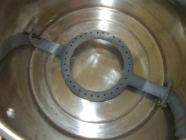

So, without a hot water system I resolved to make a system that actually worked. I bought two S/S tubs, one fitting inside the other. To the top one I fitted a 12 volt shower pump you get from the camping stores, to the lower tub I fitted a round heater ring I made up and fitted an igniter and a tap. To use simply connect the hose between heater and bottle, fill the top tub with water, turn on the heater and plug the pump into a 12 volt socket. It took around 2-3 minutes to heat to shower temperature, but best of all it worked in wind and rain and wouldn't set the surrounding bush on fire.
What about safety, regulations, bla, bla, bla? Not in the habit of wrapping myself in cotton wool, so it suited us fine, and would you believe it after being in use for nearly 20 years both the wife and I are still haven't been burnt to death or blown up, goodness we're a lucky pair.
I also bought one of those pop up shower cubicle thingies. Took a couple of shots to work out how to fold it back up.
I've since replaced the top tub and pump with a pump up pressure shower I bought at the local camping store. Much better, no need for a 12 volt pump.
