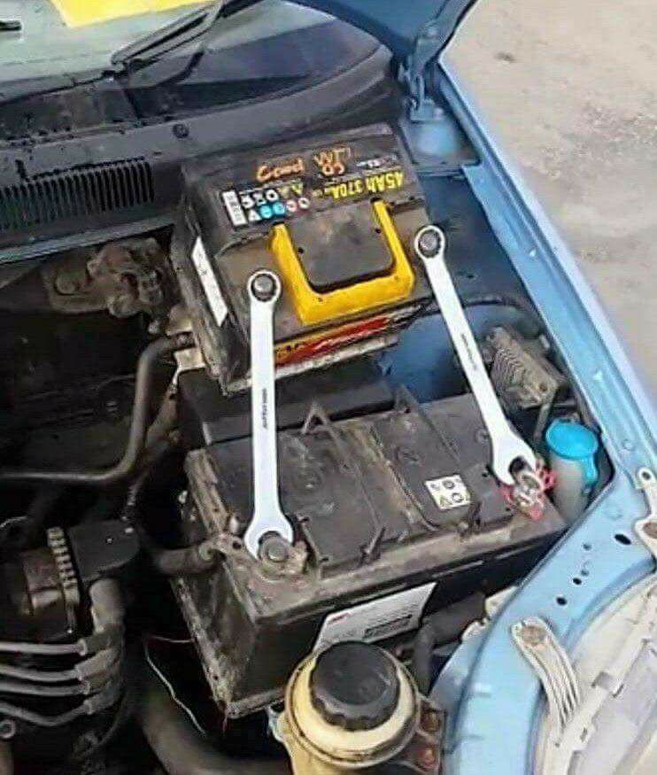

Aus-Kiwi wrote:
Is there a choke in wire size ? The dreaded VD ?
-- Edited by Aus-Kiwi on Monday 29th of May 2017 11:12:36 PM
Aus Kiwi hi
That photo remined me of time I had stopped for dinner up the track when I came out all fired up to make the big mile, hit the key in the old KW not nearly enough to turn it over, had a light pair of jumper leads and I hooked up to a nearby farmer's tractor, still not quiet enough juice running though the leads by this time I had a small amount of people watching, this older guy (Myself was youngish a bit green) stepped down from his truck gradded the 2 leads put them on the positive and then reached over to my trailer, pull out one of my cross bars, wedged that between my truck and the tractor, he said "give that a go youngan ". That my friend was a real usefull lesson in electrics, used it a lot over the years with my now 50 year old light home made jumper leads from discarded junk.
01:32 PM May 30, 2017
Yep . In desperate times we have used a welder to start old diesels Fordson Mager tractor etc. But it has to done carefully only applying the welder while cranking . We have also run Bull bars together as you had done and doubled up on jumper leads on + positive side !! Even used 24v on half dead batteries just to have enough grunt to turn motor fast enough to start !! NO WAY would I do that to a modern vehicle with delicate, expensive ECU etc !!
