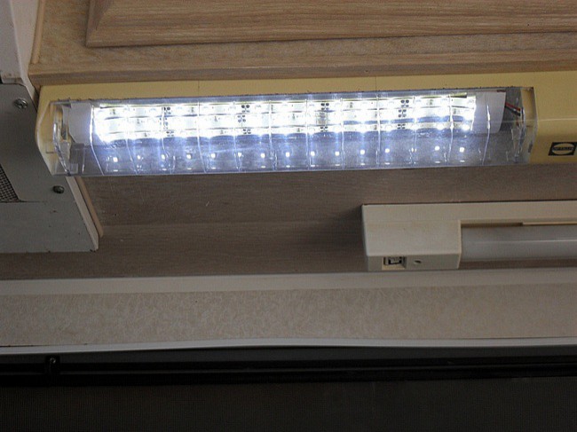

G'day Mike, I have a 95 Coromal Capri 625 Had the same problem as you,
What I did with the fluros was, rip the tube out and buy a strip of L.E.D. lights with sticky backs off Evil Bay, I filled the centre of the casing with three rows of led's and they made a heap of difference to the light output, used the existing 12v wiring , no problems,
best of luck K.J.
-- Edited by kiwijims on Sunday 21st of May 2017 04:26:39 AM
