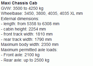

I lost the piece of paper, but the total weight of my motorhome, as per my avatar, was 3150 Kg on a public weighbridge about one year ago
This is less than Aggregate of 3850 Kilograms, as per my Licence papers in the snip below
Before my next big trip I shall pay twice, to have the front, and then the rear axles weighed
I am led to believe (from the net), but have not seen a compliance plate, (on my motorhome), that I am allowed, as per the snip below for my vehicle
If my vehicle was not a Maxi chassis then it would be
Front axle 1850
Rear axle 2000
Therefore I am compliant
