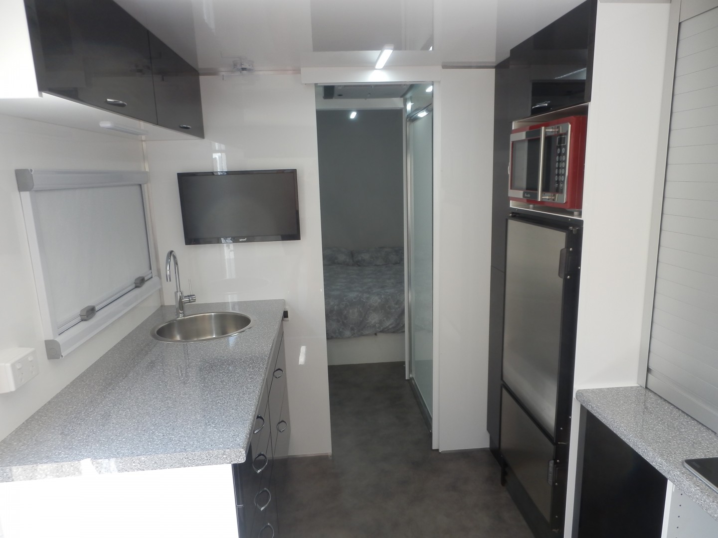

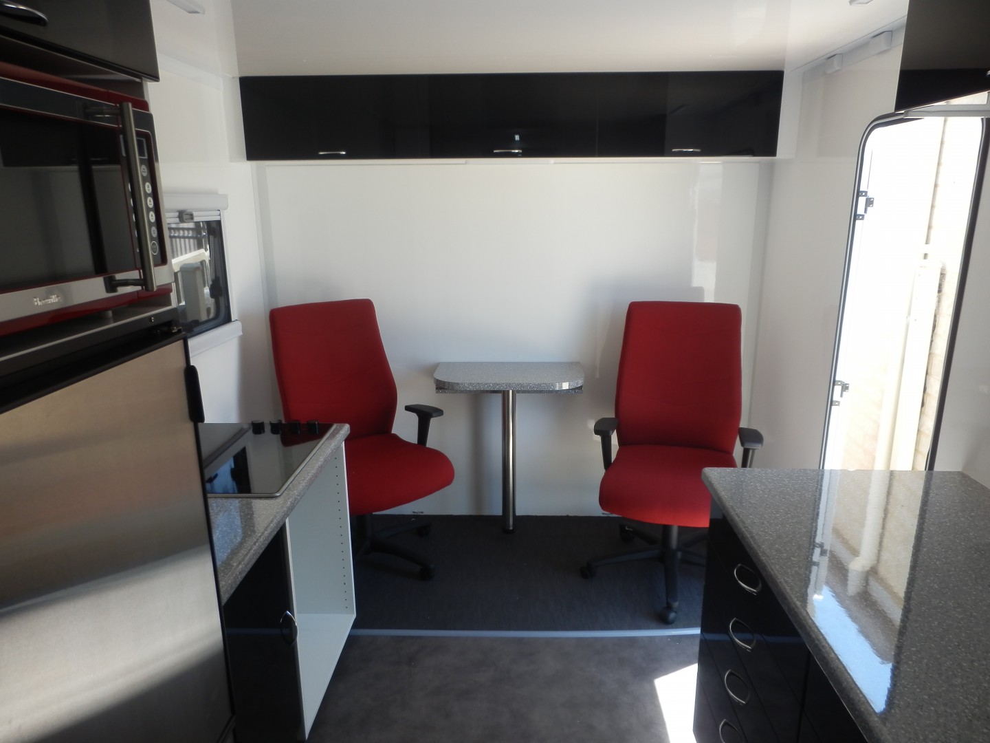

Good Morning Allan.
Weigh bridge cert. was 2160kg.
I have attached a couple of pic`s for your info
Regards.
Gary
Looks great!! What did you use for the wall panels?
Hi Allan.
IKEA produce a "Coverpanel" which I used for all internal walls, panels and sliding doors.
Its MDF, and 16mm thick, full gloss on both sides and 3 edges.
I used 16mm aluminium channel screwed and glued to wall and board.
Regards.
Hetho
