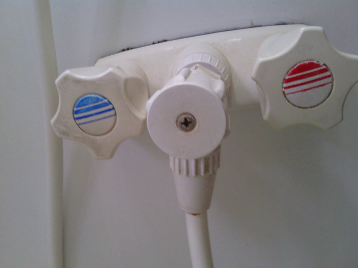

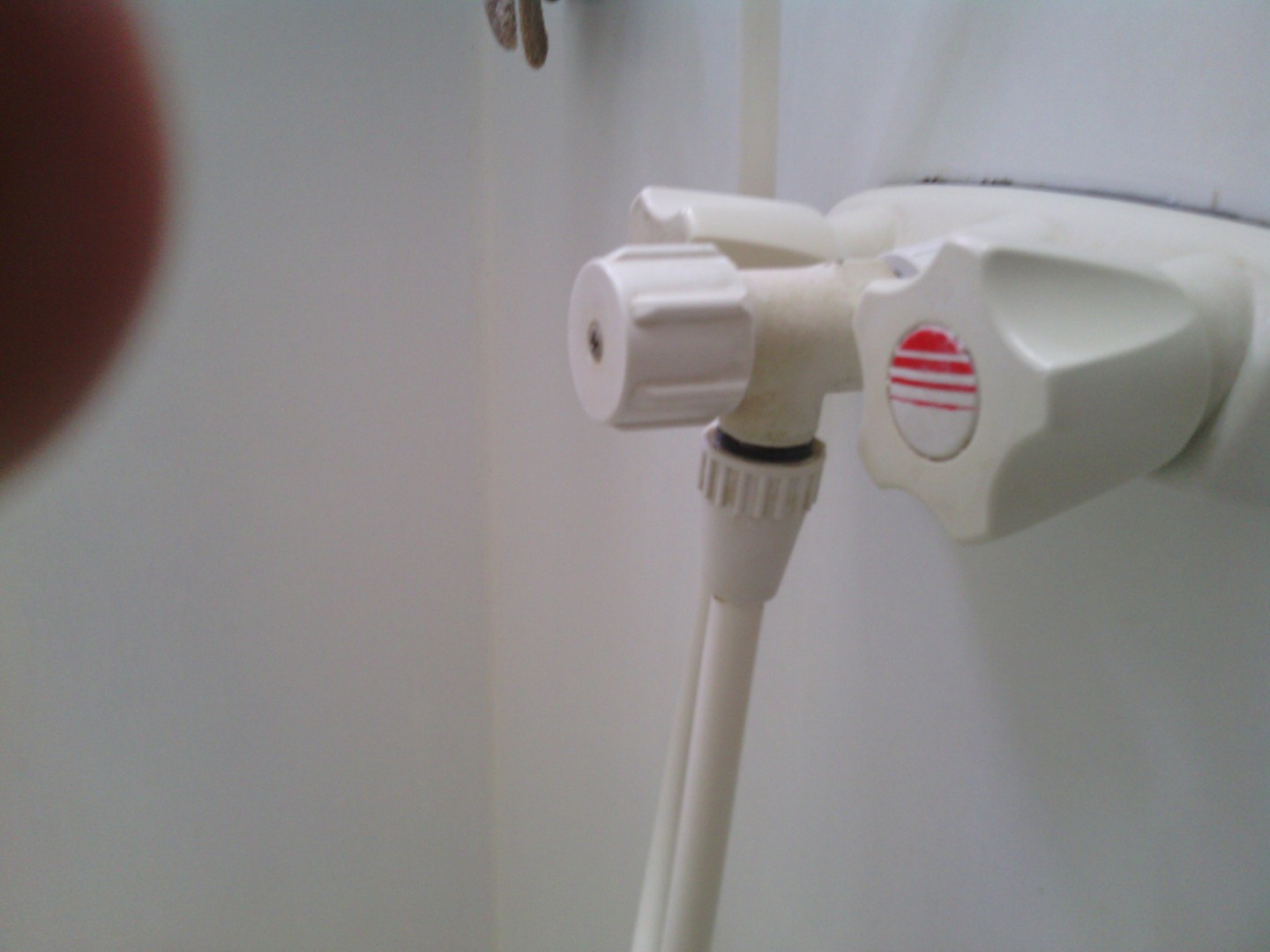

Baz421 said
12:00 PM May 5, 2017
Hi Sol
THERE IS A VERY SIMPLE SOLUTION which we use in the bush to save water and still have a good shower, I used this on boat for years also.
Fit a valve as shown in pics (Bunnings sell em about $8 or so).
How to use
1 start shower as normal
2 get under get wet
3 turn centre tap OFF and soap up/shampoo hair etc
4 turn tap ON to rinse and hot/cold mix is preset so no wastage
5 repeat if necessary.
THIS METHOD SAVES HEAPS OF WATER and u can soap up wash hair etc but the flow is ON when needed and OFF when not needed. Pretty simple to instal 10 minutes tops.
Hope this helps.
Cheers Baz
-- Edited by Baz421 on Friday 5th of May 2017 12:03:20 PM
What you really need is a tap setup like Baz has but if the white pipe hanging down was an on/off lever you could simply turn it on/off with your knee similar to how you turn those taps in hospitals on/off with your elbow.

Tony Bev said
03:34 PM May 6, 2017
While looking at the third tap, which Baz421 has recommended, (thanks for that Baz421)
I had a squizzy at my own RV shower, to see if I could fit the same system, (which I will) before my next trip
There is a restriction already built in, just before the third tap will go, so I do not think that a water saver shower head, will be any benefit
I lose water each time I open the two taps, to get the correct temperature for my body
Unfortunately for me, the water temperature must be (warmish) correct for my body, otherwise I can not use cold, or hot water.
We always turn water off when soaping up then on again to wash off.
Theres a few things here to look into anyway.
