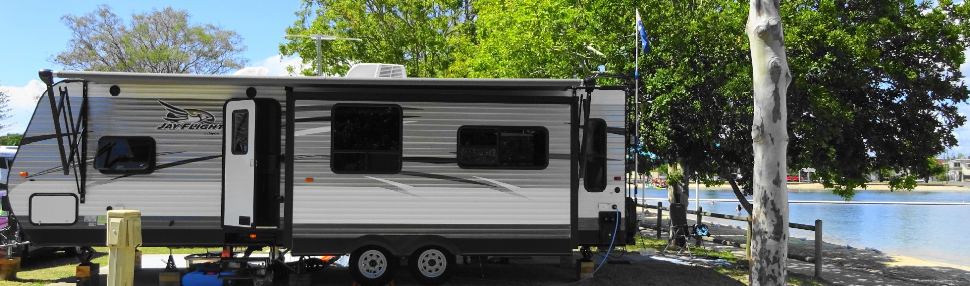

HI David,
A lot of good advice above so i will keep my 2 bobs worth brief
After you go 20' and above its all academic as to what suites your life style.
We started with a 24' two years ago and quickly learnt that it was too claustrophobic in the confined space and that parking a bigger van was sometimes actually easier.....on the open road if your tug is adequate the extra few feet is of no concern.
We currently have a Jayco 28 ultralight 2016 model weighing in at 2.8 ton fully loaded and use a 2007 Navara 4 cl diesel to tow which is great.
The point is that our Jayco 28 is 6 months only [and for sale with a paid ad on this site] and were going for the same model Jayco but a tad bigger ...because we can, life's too short !
We have never had a problem finding a great [mailily waterfronts] in the last 400 + camping [Glamping] nights ....we only need 10 meters the same as the old Jayco 25 Silverline.
Happy to show you through anytime
Happy trails
Cheers John & Louise
Waterfront site Gold Coast
