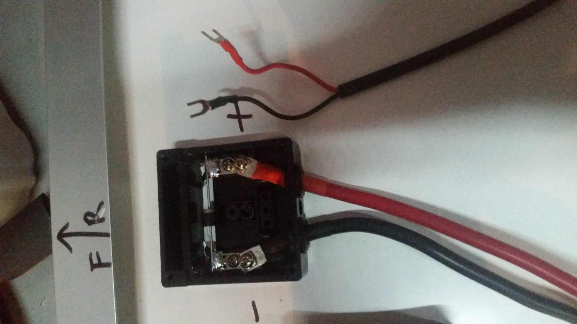

kezngaz said
08:18 PM May 19, 2017
Ok, so ive been shopping now so just need to put it all in and on. Thought id upgrade the cable on the back of the new panels first.......
Id have been lucky to get 1.2v with the original wire i think!!
You would have gotten the voltage, just not the amps, look at voltage as the pressure in the pipe and amps (current) as the water flow. Block the hose off and the water squirts much the same out of a big hose as it does a little hose (volts), then let the water flow from the open pipe and a lot more will flow from the big hose than can flow from the small hose (current), cable conductor size has a similar effect.

Jaahn said
11:29 AM May 20, 2017
Kezngaz.
Hi Keznga
I think that picture is worth a thousand words about what to do with the cheap panels. The panels are OK but the crappy wiring and sometimes poor position of the reg let them down. Put some decent larger wiring and the regulator near the battery and 'Bobs your uncle'
Cheers jaahn
kezngaz said
09:42 PM May 20, 2017
Thats 6&s wire going straight to the redarc regulator @ the battery up front.

T1 Terry
Hi Keznga

I think that picture is worth a thousand words about what to do with the cheap panels. The panels are OK but the crappy wiring and sometimes poor position of the reg let them down. Put some decent larger wiring and the regulator near the battery and 'Bobs your uncle' biggrin
Cheers jaahn -sinp
