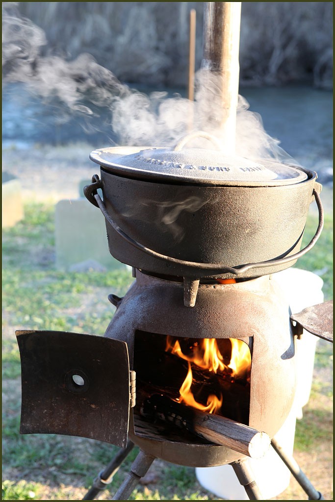

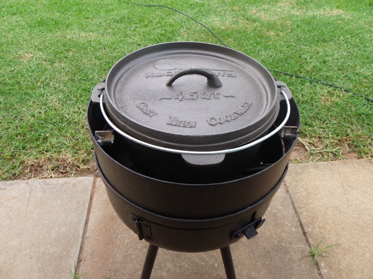

This is my liddle fireplace. Only a 4.5Kg gas bottle - but I carry it in the vehicle and didn't have enough space for a 9Kg one and I travel solo so it does me pretty good.
-- Edited by rockylizard on Saturday 29th of April 2017 12:48:46 PM
Thxs John
Just what I'm looking for thxs heaps mate

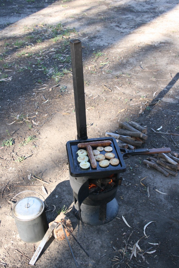

Camp Oven Nerd said
06:44 PM Apr 29, 2017

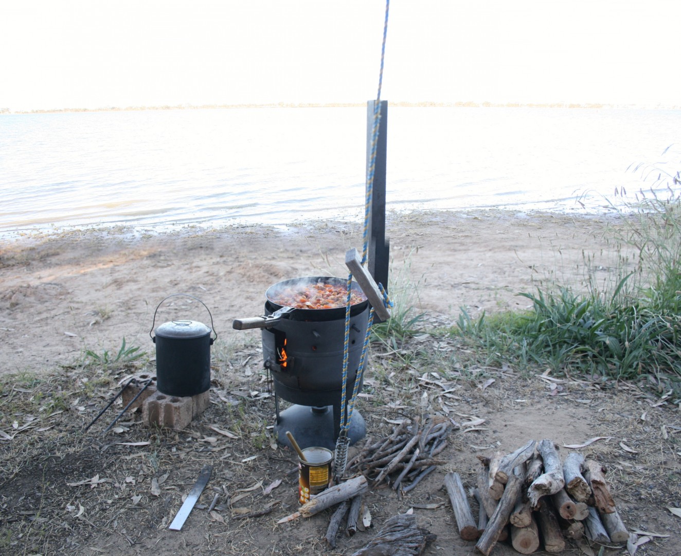

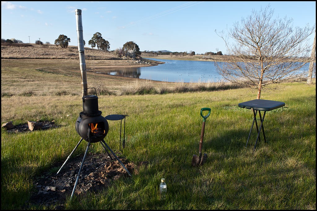

G'day mezza56, This is our cooker. The legs and chimney all pull apart and store inside the cylinder. There is a mesh grill on top or a solid plate when we want to use it just for warmth. We made a square door as it allows a double jaffle iron to pass through it. If you go this style make sure you use a 2.5" to 3" pipe for your chimney so it draws well. Happy travels.

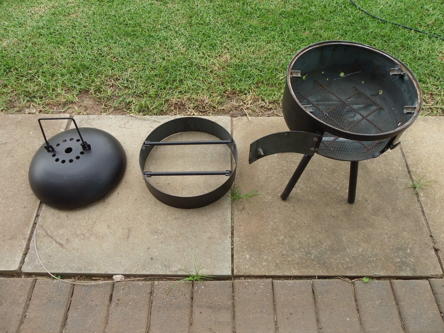

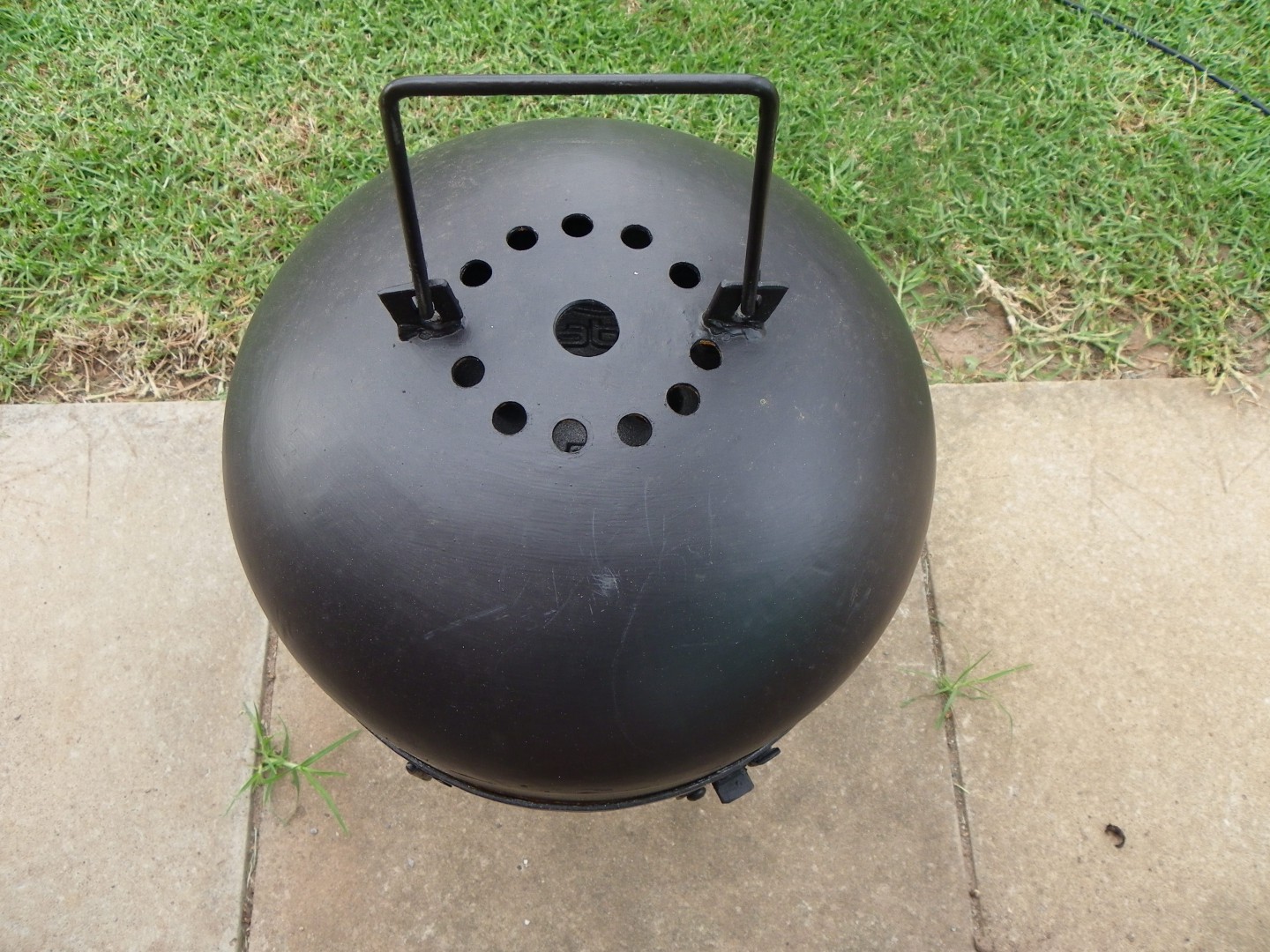

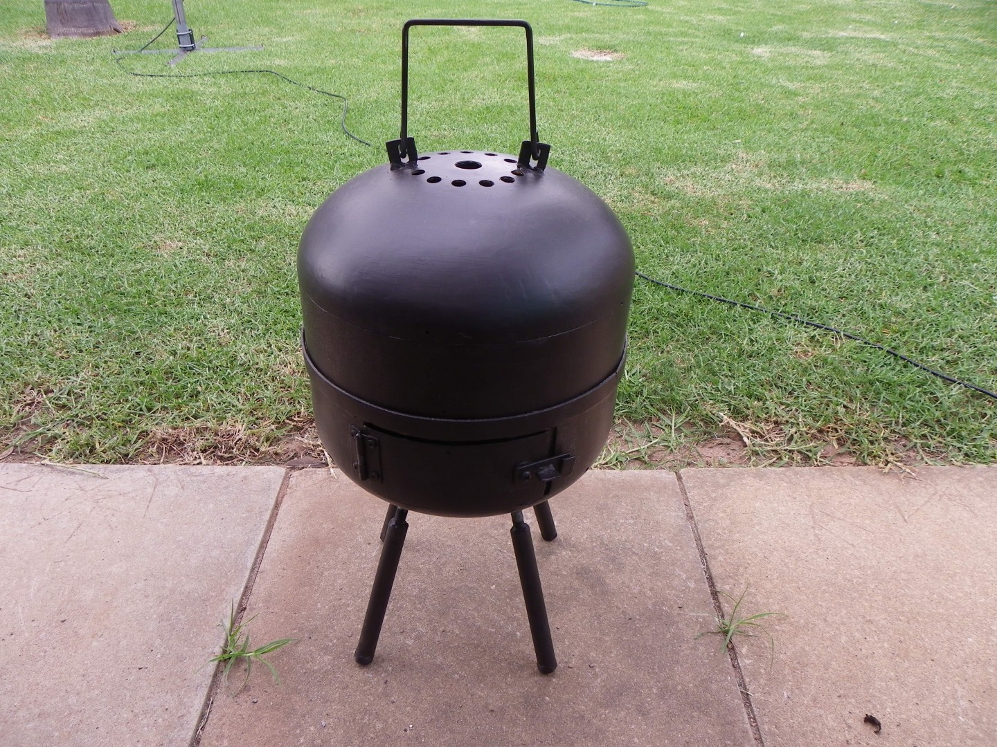

Made mine see pics.
