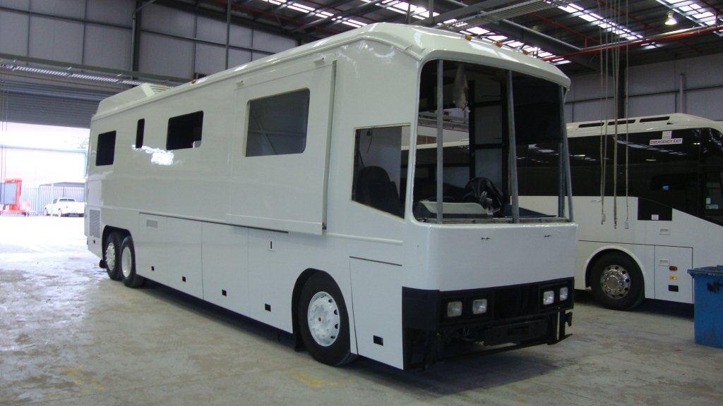

Here is my rig, or more accurately, what will be my rig
Mrbolly said
06:15 PM Apr 22, 2017

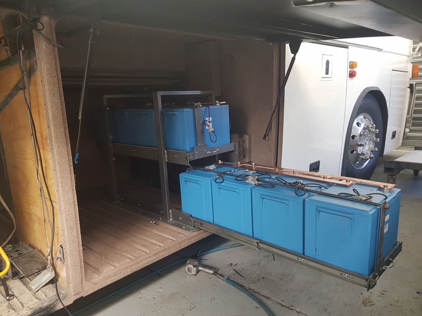

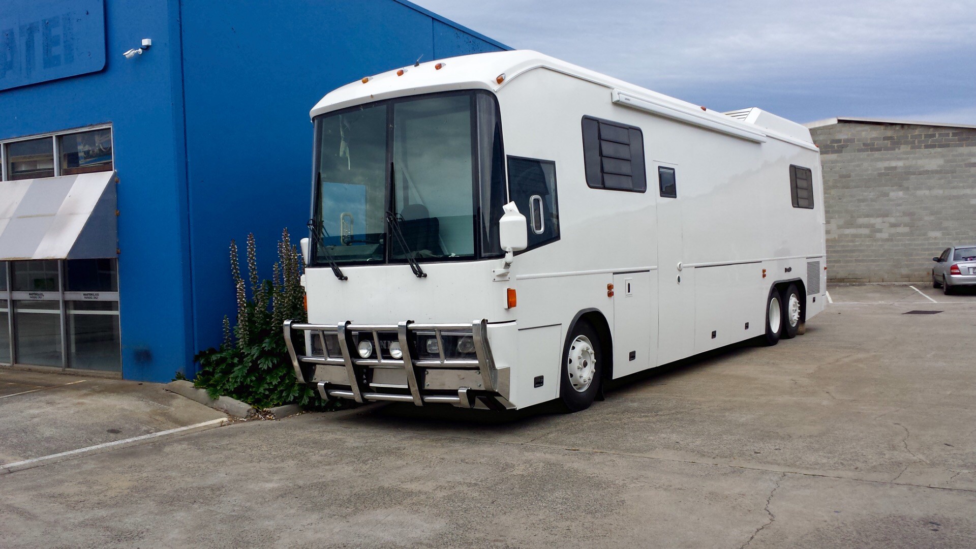

This is my first post having only just joined the forum. My rig started its life as a Denning Landseer and spent a good portion of its life as a Greyhound express coach. I bought itdirect from Greyhound and started the process of conversion by raising the roof by 400mm, relocating the entry door, putting a slide out room behind the driver that includes a three seater couch and then re-sheeting and painting.
Since then, I have populated the roof with 9 solar panels feeding into a Lithium Ion battery bank to provide 240v for the house. I have finished putting all of the infrastructure in the former luggage bins waiting for connection to the house.
i have just moved inside to start the conversion which I hope will be somewhere near finished by the end of August (as you must have a goal).
i plan to tow my Ranger ute behind on an A Frame to give us a 4WD mobility and to allow the coach to remain set up while the car is used as transport.
I am in Bayswater, Victoria and work on the coach whenever time allows.
Looks all white (ha ha) to me...
Reckon we could live in that just fine, nice job.
Interested in the lithium batteries, they don't look like any others I've seen, got any more info on the setup?

Very nice looking bus
And what an impressive battery bank you've got there ( How big is it if I may ask )

Hi there guys, the Lithium Ion bank is set up at 24v x 800amps of depth. I worked on the basis of the whole house using 240v appliances so need the grunt to feed the inverter. I have a smaller bank of lithiums set at 12v torun water pumps and LED lighting. The batteries themselves are Victron.

great looking landseer there, excellent install on the Li pack too -are the busbars copper??
