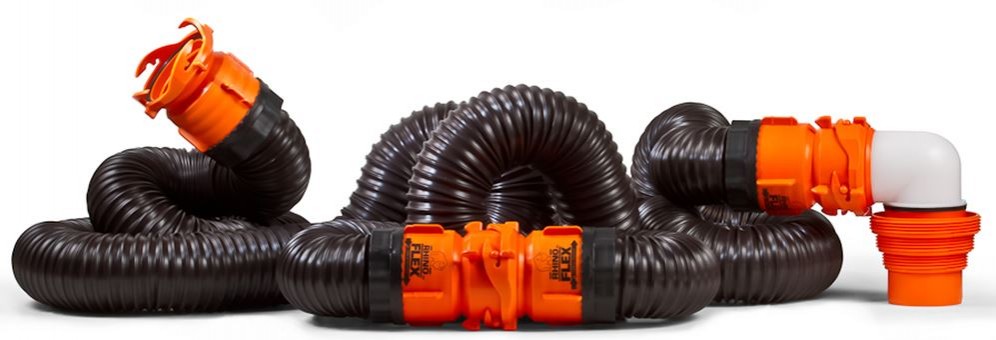

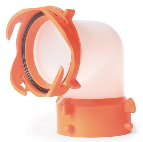

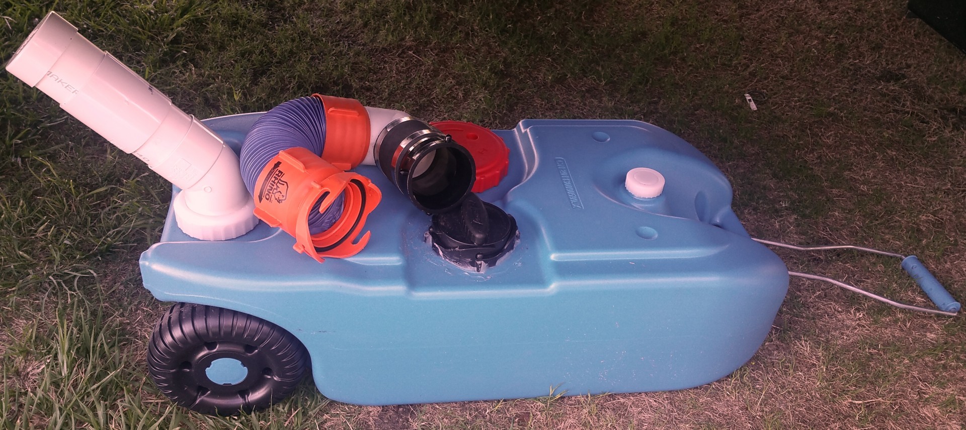

I have expanded my take on it a little see below.
With say an 18 footer you may have a 50 liter holding tank, as in mentioned in my blog, you also should have a cassette/dolly on wheels as part of the package -
Now its your choice if you want to connect the transfer dolly to the holding tank and wheel it to wherever to dump [as you say you do now]
Or... as is allowed in "some parks" connect your holding tank,via the same hose [s] as your light & heavy grey water hose [s] directly to the sewer point at your site.
Or....you can wait until you are moving your van and dump directly to the sewer point in the park, or a council dump point, or if you have the facility at your home.
It just gives you more choice and trust me, on the occasions that your allowed to connect up right at your site its soooow much easier.
Note: The holding tank package normally includes a larger house 3 inches with a "push fit multi hole size discharge end" for a good seal at the dump point [for Black, light & heavy grey water] Plus a cassette/dolly on wheels when you need to empty before you leave the site or if there is no dumping allowed in your sites sewer point.
Because of the tight fitting hoses and chemical treating of the wast water there is no odor - A couple of picks are attached for your convenience
So its all about options - if the extra cost was negligible, there is no down side.
