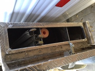

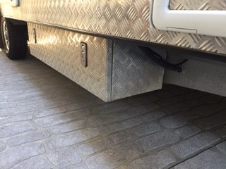

Hi John
i have 2 of these boxes that I had made up -1 each side
they are perfect for ramps a few treated pine sleepers cut to about 300 mm long as pads for jack or even instead of ramps if only minor lift needed
they are made from 1.2mm alloy and weigh about 6 kg each
i have a 150 chassis plus a 150 riser so easy to fit mine
It is tek screwed to to both vertical and horizontal outriggers and has not moved in 30,000 km of various roads

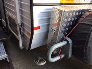

I also have a rear box that fits between the van and spare tyre for light things such as a awning rafter fishing rod etc
i don't know how to rotate first photo of rear box but it is vertical with 2 extra shelves which are about 120 mm wide so not large or heavy but extremely useful

Hi John
