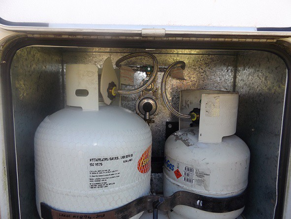

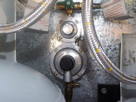

Hopefully the pictures will tell the story The background to the story is
Coming home to the west, across the Nullarbor I lost gas pressure, and therefore did not have enough gas to use the water heater This was no big drama for me as I carry a 12 volt, as well as a cordless shower
But... I was losing my three way fridge temperature, so I had to hoof it along to get home, which is not nice, when you are in travelling/tourist mode When I returned home, I found yellow stuff come out of the hoses connected to my 9 kg gas bottle
I removed my regulator and pigtail hoses, from my RV, and then connected a home-made manometer in my shed I found that the regulator was only delivering 2 inches of water pressure (I am led to believe that it is supposed to be 11 inches water pressure at sea level, in Australia)
I have no way of opening the original regulator, to clean it out (I did read somewhere that you are supposed to renew both pigtail hoses, and regulator every five years)
I decided to purchase a new regulator (which can be cleaned out), as well as new pigtail hoses, as a set item
The problem for me, and I sincerely hope for no one else. Is that the new pigtail hoses, have a hand tightening end to the bottle This make it rather awkward for me, as the bottles are in a container, and my hands are not as flexible as they once were
As they say that necessity is the mother of invention, then the pictures tell the story Which I hope is of no interest/need for anyone else
New regulator fitted, as you can see if it blocks up again on the Nullarbor, then a gas fitter will be able to clean it out for me

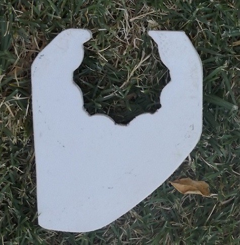

Spanner I made to fit the bottle ends of the pigtail hoses Made from 4˝ mm (3/16 inch) hard plastic
Why I wanted a spanner for my situation Spanner will not stay there, it will sit on the floor of the gas container when travellibng
But...
