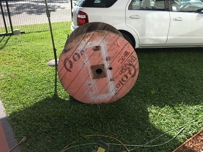

Long story short, I sold my solar panel cleaning business in August 2016

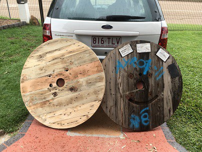

Anyway, I had a void in my life that needed filling and one day I got hold of an old Cable Reel
One thing led to another and I found I had a knack for up-cycling these tired old things....
Now I do them up, sell them and if funds my ongoing obsession...
If anyone is in the Townsville area and wants one or would like one done in a particular way, drop me a message and I can certainly do something for you...

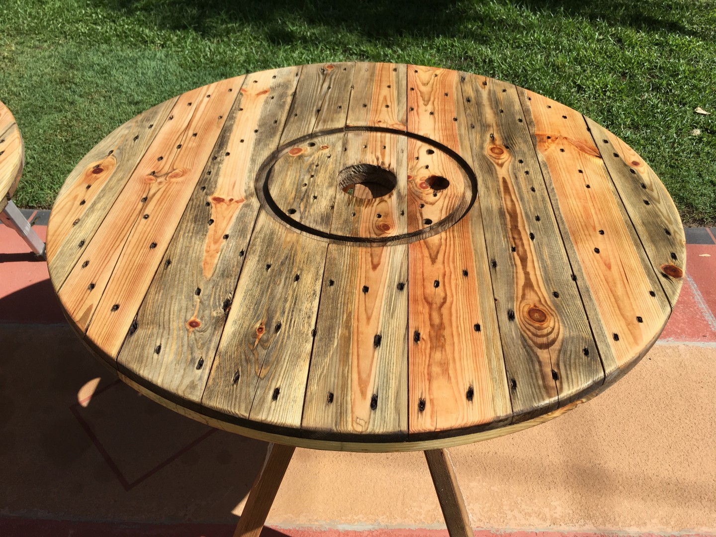

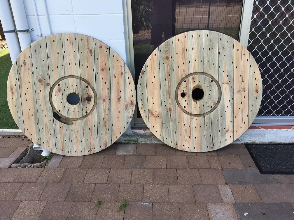

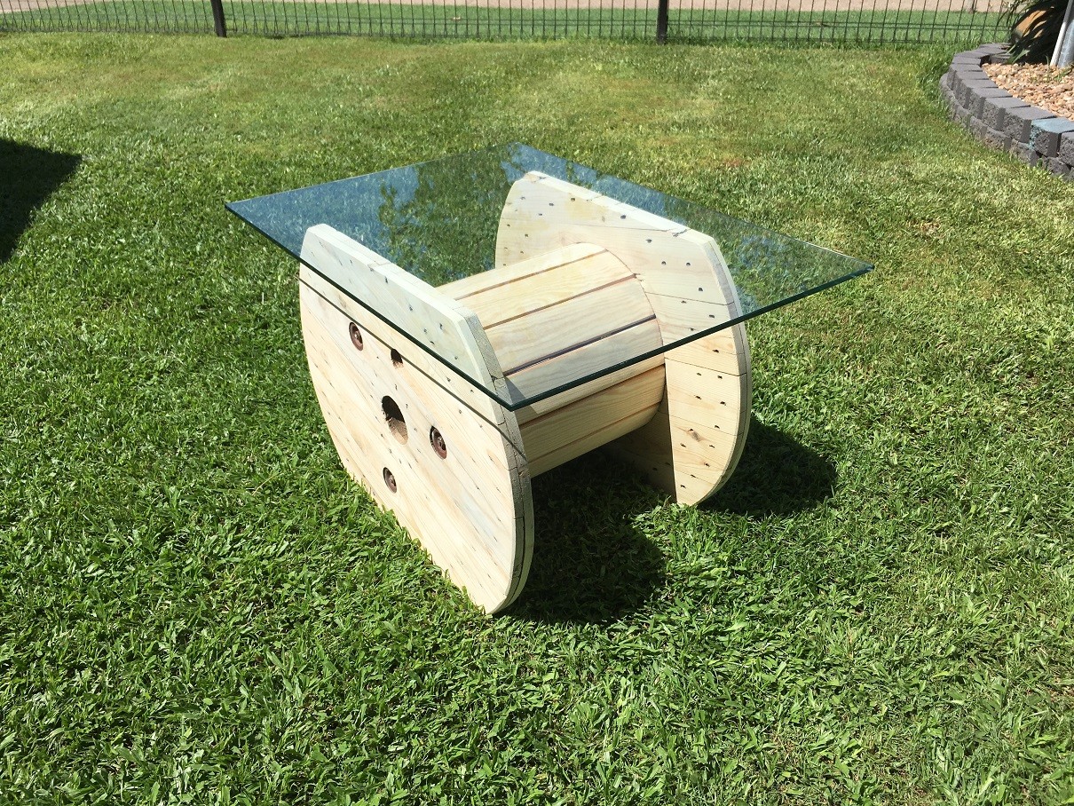

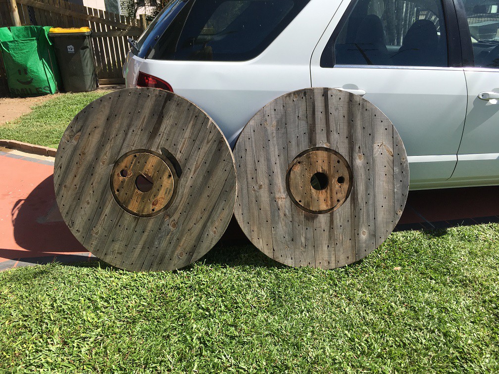

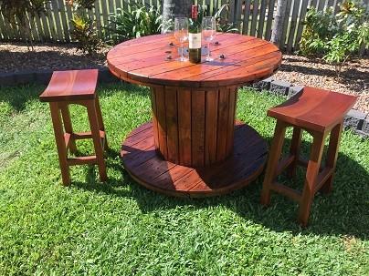

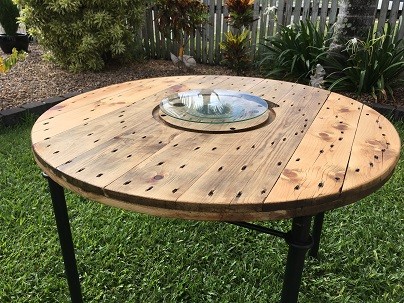

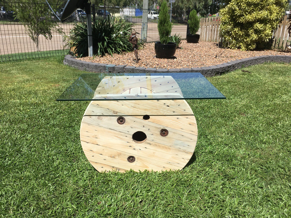

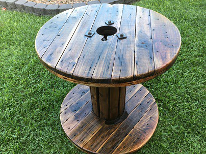

Thanks mate, it's like unwrapping a present everytime I do one... not sure what your getting till you remove all the paint etc...
Some beautiful, colours and grains in the wood....
See the attached pics and you'll see what I mean about bringing out the true grains in the wood....
