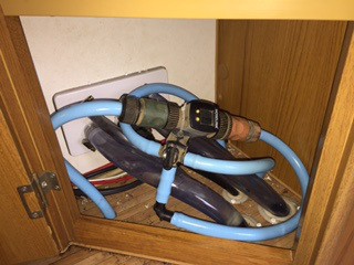

I have arranged the tank selector to be in the cupboard where all the filling and air hoses sit. Also included a flow meter to count the liters used. It looks a bit of a mess but need to be sure the proof of concept works.

Like the flow meter inline, great idea to keep an eye on usage and what really is remaining in the tank.

I would not be relying on a flow meter to extract every last drop of water Paul
I recently had the pump spitting a bit of air, when I was supposed to be about a quarter full I assume it was the angle of the tank, so now I make sure that I do not go below a quarter of a tank
