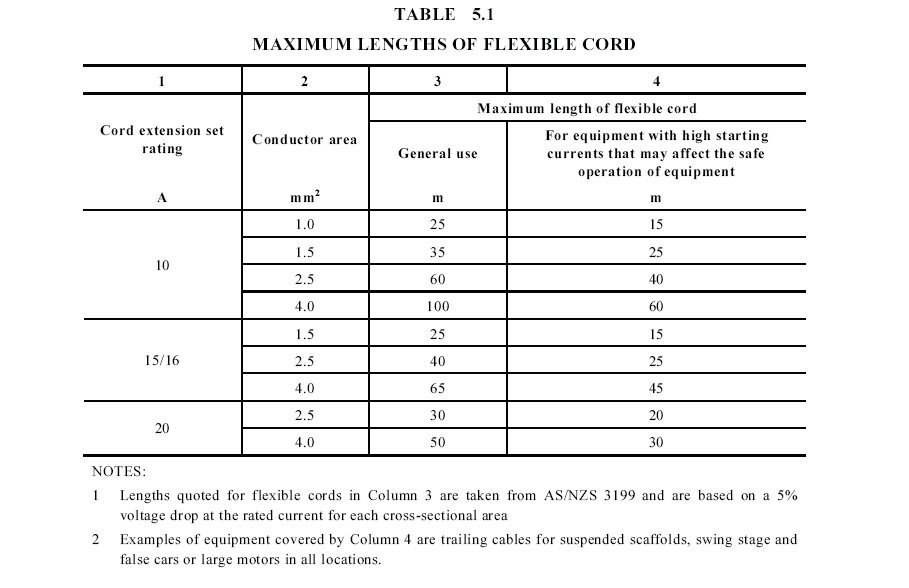

10:09 PM Mar 15, 2017
SouthernComfort wrote:
The 10m lead my van manufacturer supplied is 15amp / 1.5mm conductor. I also bought (probably too soon) a couple of Bunnings leads of the same spec. So where does 2.5mm come in? Are we saying the supplied 1.5mm is inadequate or dangerous?
The specifications for power leads provides for a maximum voltage drop is 5% at the longest permissible length for each size of wire. For 15A leads constructed with 1.5 mm2 wire the maximum length is 25m, 2.5 mm2 cable it is 40m and for 4.0 mm2 the maximum length is 65m. If you are going to use the 15m cables for equipment with high starting current (eg large motors) then the lengths are reduced to 15, 25 and 45 metres.
There are two main reasons for not allowing leads to be joined for supplying mobile and portable dwellings is that most people don't protect the joins and also there is a high probability that the combined length of the extended lead will exceed the maximum length for the size cable you are using (and thus the supply will have more than a 5% voltage drop.)
Mike Harding said
12:33 PM Mar 16, 2017
PeterD wrote:The specifications for power leads provides for a maximum voltage drop is 5% at the longest permissible length for each size of wire.
That's interesting, I didn't know that. Which standard specifies that Peter?
04:21 PM Mar 16, 2017
Mike Harding wrote:That's interesting, I didn't know that. Which standard specifies that Peter?
Which standard is the table from ? The footnotes reference AS3199 but I'm not clear if that's it's origin?
And, sadly, Australian Standards are not available unless one purchases them which is a travesty of all that is just and honest! Imagine having to buy the Crimes Act in order to find out what was legal!?
Hi Peter
Thanks for that.
AS/NZS 3199:2007
Approval and test specification - Cord extension sets
