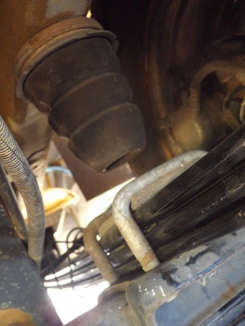

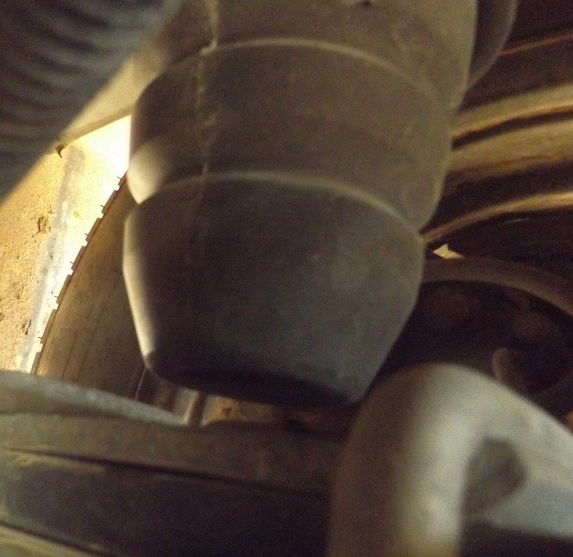

The two pictures tell the story, you can see the different ride heights of the bump stop, before and after the modification
Before
After
