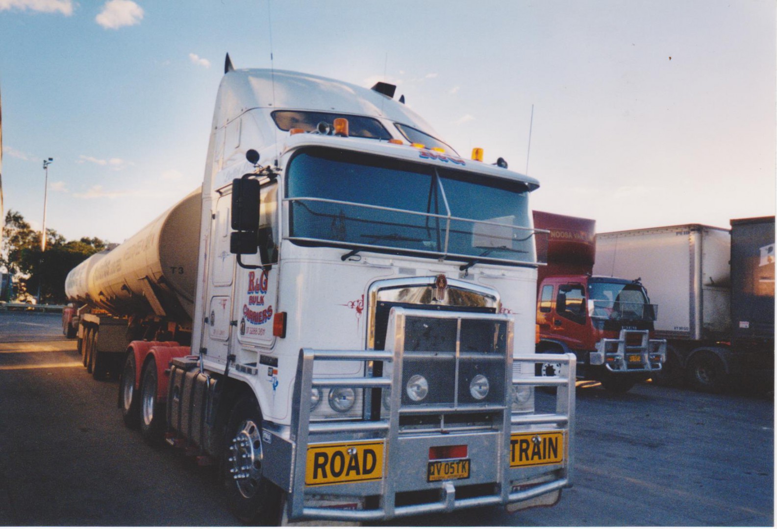

Fringe Dweller said
10:19 PM Mar 10, 2017
They Don't do anything.
KJ . How much grime is on the back of your Patrol . HEAPS . And it IS there Because of DRAG.
Agreed , some of the wind will go over . But NOT enough to make Any difference.
Then there Are the air con & hatches on top & all th stuff underneath . ALL Creating DRAG.
IF the deflector was So good on Prime-movers . Why do the Have nose cones too.
I will post 2 pics , on the Western Star is high rise bunk & deflectors , on the KW it has aerodyne bunk & further deflectors on top.
I also towed Bdouble T liners with this truck. But with the Star note how Close & streamlined they are & Nosecones.
To answer your first question Fringe Dweller, There was no noticeable dirt on the rear of our patrol,
Now please tell me, if as you say these wind deflectors don't do any good at all, Why has the truck in your photo got a dirty great wind deflector attached to the cab ???
As you stated, they don't help with the Drag, I suggest that with a great flat surface on the front of your rig, would be causing a heap of drag,
For the life of me I can't see what use a nose cone would be, apart from making the wind blow a few insects off the wind screen.
Anyway, everyone to their own opinion , and I do know that as far as the wind deflector on our Nissan went, it did the job and I was more than happy with the results.
K.J.
