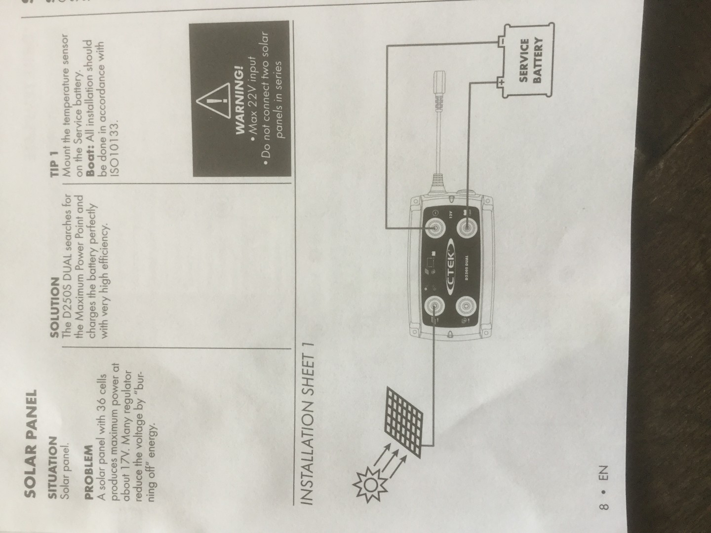

reading the user manual of this unit implies that I don't need to power through the mppt that comes with the solar panels. Just connect straight to d250s Does anybody have info otherwise?
You are correct - use only one charge controller as shown on the picture. The D250s common earth is the battery negative/earth connection (as per the pic).

hi all
Also where do I connect the earth. Thanks.
