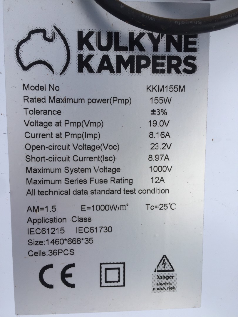

ok so the other day my new panels were charging in full sun around 8 + amps brought it out of the shed for some more maintanance and noticed there was no charge from the new panels , now all connections are good fuses are good even checked them for continuity all good am getting just 2 V and no amps.
any ideas please is it likey that the controller has died
pannels are 155 w short circuit amps 8.9
regulator is 22 amp
