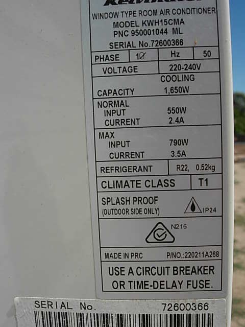

This is a Kelvinator A/C ive fitted to a 12Ft pop top van. It works great even in 48deg C & a 1Kv generator starts & runs it easily. Have made a canvas cover for traveling.

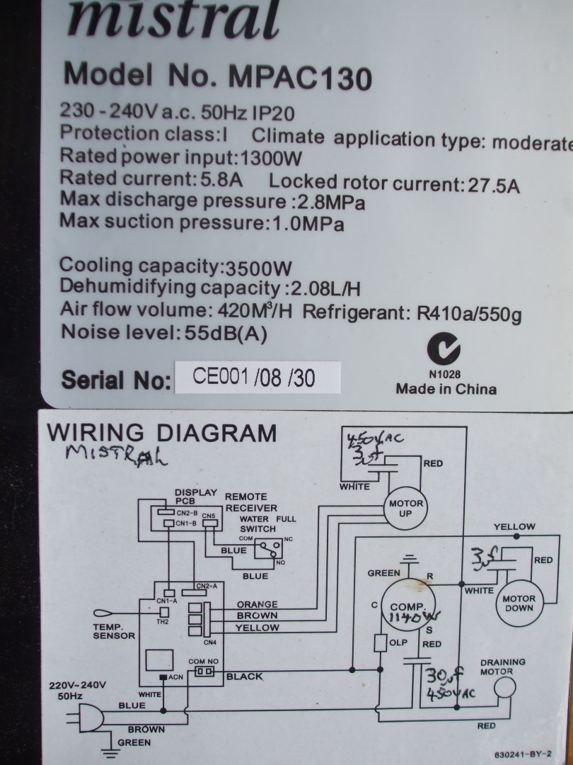

One of the problems with so called portable airconditioners is there efficiency. They are power hungry & the ones with a single exhaust vent is pinching your cold air & pumping it out the vent. This is creating a negative pressure in the room & sucking in external hot air. Yes I have repaired a few for other people, but wouldn't own one my self. This is the spec plate of a Mistral unit I repaired. It uses quit a lot of power.
