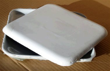

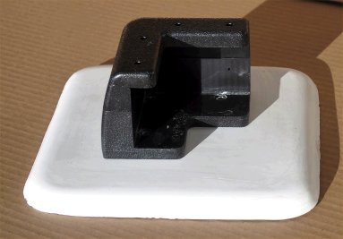

Progress has been slow, but I have had 5 pads made up of fiberglass, I brought some cheap dishes from the Big W for $2 each, to use as molds. Have brought stainless screws and nuts 4mm x 16 long, with the nut fitted into a counter bored recess, the plastic mount fits the pad quite nicely. Next step is to drill and counter bore all of the pads, The fifth pad is to be cut in half and have the center mounts fitted to them. I'll fasten the pads to the roof of the van using Sikaflex 232, no screws into the roof of the van.

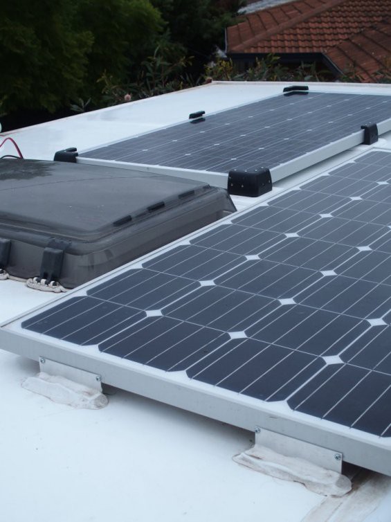

Had some time over the long weekend, and the temperature was lower. Washed the area where the pads were to be stuck down with detergent and then acetone. I used Sikaflex 252 as recommended on their site. $32 bucks a tube, comes in what looks like an aluminum tube, and is quite hard to apply. All went well though and the pads are firmly stuck down on the roof, no screws, no holes. With this style of attaching bracket, the solar panel is removable, which down the track may be handy.

Gosh, I didn't measure, can do if you want, but the clearance was what was built into the mounting feet, plus that of the fiberglass pads, which were about 10mm thick. I have only just connected the panel up two days ago, as I had to re-do the electrics about the battery installation. Part of connecting up the panel, and a diesel heater. I think the air gap would be about 25mm, not as great as the two Jayco installed panels. No screws or rivets have been used between the pads or the roof, I screwed the feet to the pads using the holes provided.

FYI the panel to the bottom of the mounting bracket 10mm, the clearance of the mounting bracket plus the fiberglass pad 20mm, the clearance of the Jayco installed panels 35mm.

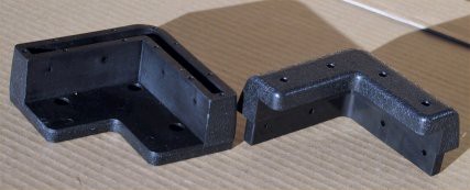

I've been scratching my head trying work out how you remove the panel once mounted, it looks to be trapped from both sideways and end movement even if the screws are removed......... or are the mounts a 2 part thing where the outer section comes away from the mounting foot?
T1 Terry
Ummm....... The photos on a previous post didn't appear before I made this post, I can now see the mounts are a 2 part thing, what a great idea, well done and thanks for sharing.

Hi Terry, yes the panel I installed is removable, each mount is in two halves, sliding into each other. The side screws lock the mount together, and the top screws are to clamp the panel down to stop movement. What happened, I just went to Jayco shop and asked for one panel to match what I had already and mounts, that's what I got. I had been toying with the idea of making the panel removable and turning it into a portable panel, if I was going to stay at one place for a while during winter when sun hours are minimal, with the panel tilted, I could get more power to the batteries, while in the summer months mounted flat on the roof would be OK. So using the mounts leaves my options open.
I have a fiberglass roof and intended to glue the mounts on the roof, no screws or rivets, but the mounts supplied, I felt did not have the surface area that I was satisfied with, hence the pads. There are white mounts on the market which look as though they have a greater foot print, and may be ok to glue direct, and if the panels are to be mounted permanently, the aluminium angle is the go.
So I have screwed the supplied mounts down to fiberglass pads (to give more surface area for gluing), the pads a Sika flexed to the roof. 20 screws and the panel comes off.
