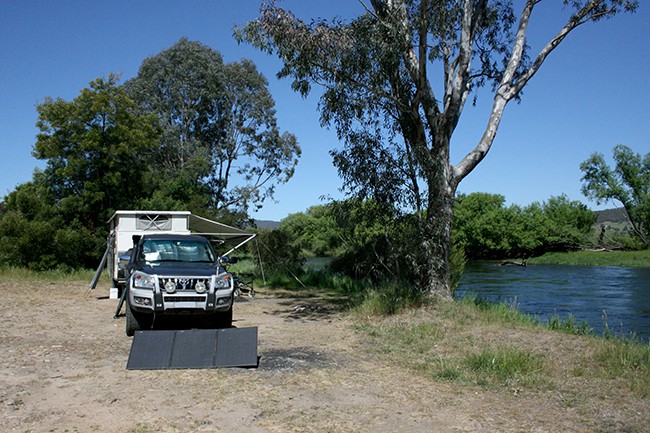

Onedodger said
03:01 PM Jan 22, 2017
Get youself a folding 120 watt solar panel that way you can camp in the shade and have the panel in the sun connected to and charging your batteries.
I used this system for years without problems.
Just make sure you set the solar up even when you arrive fully charged as they will then replace any power used in daylight. It is not good to run batteries down before atemting to charge them.
The cost of a solar setup is approximately 300 dollars or less where a good 1kva genny will be double that.
Then there is extra fuel to carry and the list goes on with a genny.

Jaahn said
04:12 PM Jan 23, 2017
Martin,
When I had portable solar panels I made up a stainless cable ~4mm at the marine store with an eye made and crimped on at each end. A bit longer than the electrical cable ++ and then you can lock it to the truck/van and put it through a hole in the panel frames. Stops the casual thieves.
Now I have the panels fixed on top but if I was doing what you do I would take another pair for portable instead of a genny. Or now I just start the motor and charge at 100amps if the batteries get a bit down!
Jaahn
PS panels are a lot cheaper now so the bastards are not so attracted to them as they were before.

Plain Truth said
08:35 PM Nov 13, 2022
We cover all bases,a fixed panel on the roof,a 150 watt lightweight folding panel for the 60 litre Engel combi fridge and a EU 10i if it clouds over for to long.
HI Plain Truth,
Out of interest what brand are your lightweight solar panels and what output do you get from them?
Tim
