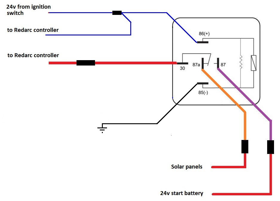

I have a Redarc BCDC1240 controller with a relay to switch the input between the solar panels and start battery. It is wired as per the diagram below but not sure if this configuration will work with your sbi unit (there are a few models on Redarc's website). But the diagram will give you an idea on how two charging sources can be switched via a relay. This relay http://www.narva.com.au/products/browse/changeover is similar to the one I use.
Hi Eaglemax
Hope this helps. Cheers
