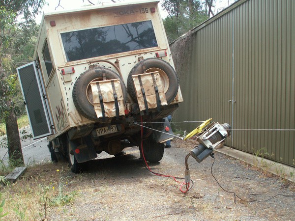

Peter_n_Margaret said
10:56 PM Jan 9, 2017
blaze wrote:
buy your self a 6/7000 lb winch with dyna rope and mount it on a bracket/mount that will slide into your towbar receiver, have a towbar receiver fitted to the rear of the van also, fit a couple of heavy duty Anderson plugs, buy and use a sheave to halve the pulling effort required. When solo vehicle you never want to pull yourself further into the **** cheers blaze
This is a 16,500lb Warn that can be used as you describe or as shown in the pic and attached to any part of the vehicle and pull in any direction.
Works extremely well, but weighs about 70kg. All "ropes" are Dynema.
Well as usual I am ecstatic at the common sense answers I have received, thank you. We have decided as most of you have suggested to go with the long handled shovel and the, acutally, Treds. Thank you again.

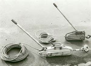

gandk said
10:06 AM Jan 10, 2017
Also will look up the little gadget above, my husband thinks it is called a turfer. He used them during his days at the coal mines.
11:54 AM Jan 10, 2017
We used a Turfor for some 12 years.
To be effective, you need a big one. They are very heavy (but not as heavy as an electric winch) you will also need at least one snatch block and straps to anchor it to something but most of all, they are extremely hard work and extremely slow.
12:52 PM Jan 10, 2017
The other option is a fitting that fit on your wheel nuts a rope to a tree or spike driven into ground . Any wheel slippage ? The rope pulls you out . It's like a small rim with a fitting to tie the rope . It's simple and light . Can be used on any wheel . Or buy one of these ? http://www.bushwinch.com.au

C00P said
01:56 PM Jan 10, 2017
The correct spelling is "TIRFOR" but Turfor will get you to the right pages on Google...

Yabbietol said
05:20 PM Jan 10, 2017
Have a look at the bog out I mentioned above, not used it, but looks safe simple, light and cheap. Interestingly they sell them as pairs, which would be for the most difficult situations and singly for less extreme bogs.
Tirfor's are very good but need practice to use and they take a lot space and are heavy and as mentioned above can be hard work. They also use a steel cable under a lot of tension which is dangerous. Most bogged 4WD need a Tu16 which is quite large; they are reliable and only need muscle power.
This is what I was trying to describe. No other attachments required.
