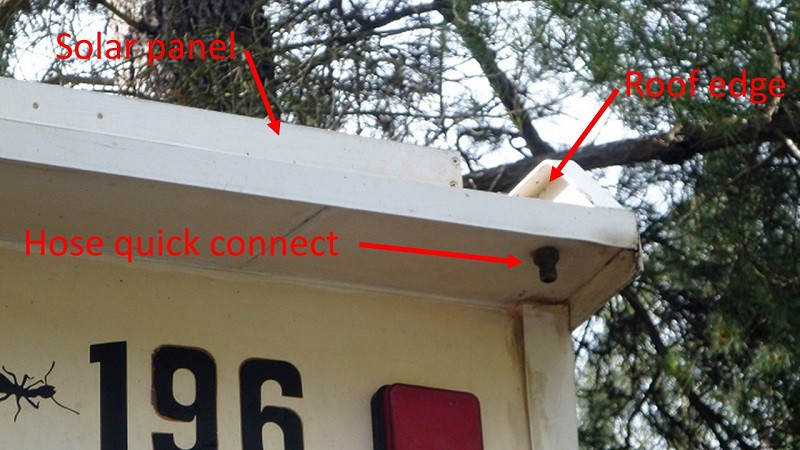

Thanks for those tips everyone - I think I'm more inclined to do something on the roof, like in the post by Hobo Home http://hobohome.com/news/?p=161. But with modifications. When it's raining it's often blowing and I don't like to have the awning out in case I lose it. And sometimes it rains while I'm driving and that could be awkward.

I collect water from the roof of the OKA and take it by hose directly into the tanks, but the ability to do that was part of the original design.
Yes, this is something like the design I am interested in - and my roof is flat and square edged. Thanks Pete
