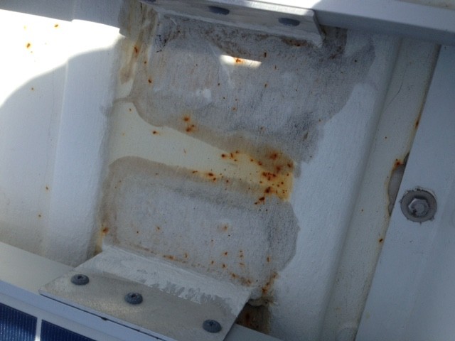

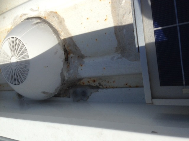

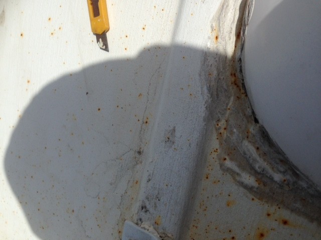

This an Awning Installed by somebody recommended on this site. Please be Aware, Check and don't take anybody's word. This could happen to you. I'm gutted. It has taken me days and money to fix somebody else's FU. Metal Filings + Rain Water = Rust. He should have cleaned up after the Job or at least asked me if i would. Beware. They are out there. He said it was 1 in a 100 chance of happening. BS I say. Chucker

When he first fitted the Awning it sat up that high that it looked like a Billboard.. So because I said it's too high , he cut it down by half. Grinding and hack sawing to make it fit. OMG complete disaster. I decided to take the Awning off to check what was under the track while I was repairing the roof rust. Thankfully I did as down the track all those metal Filings would have been rusted. There was heaps of them. Is it my fault that I didn't check for Filings , maybe, and hopefully others get something out of my mistakes...

Sorry . Filings on the roof that have rusted.

It's like this :
He said he needed to raise the Awning above the door so that it wouldn't rub against the door when it was open.
Therefore he added an aluminium border, then he made it too high and had to cut it back (grind it by the looks of it)
and there's your Filings spread all over the roof. .
