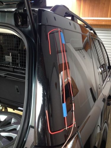

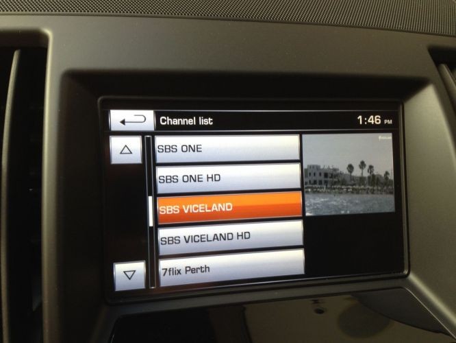

One of my compatriots has installed TV in his Land Rover. The system uses 4 amplifiers & there is a aerial behind each of the D column external plastic trim panels & 2 more aerials behind the rear bumper.

I had noticed the 4 year old thread & did my bit to drown out the spam. One can make your own aerial out of wire as in the photo & not waste money on rubbish.
