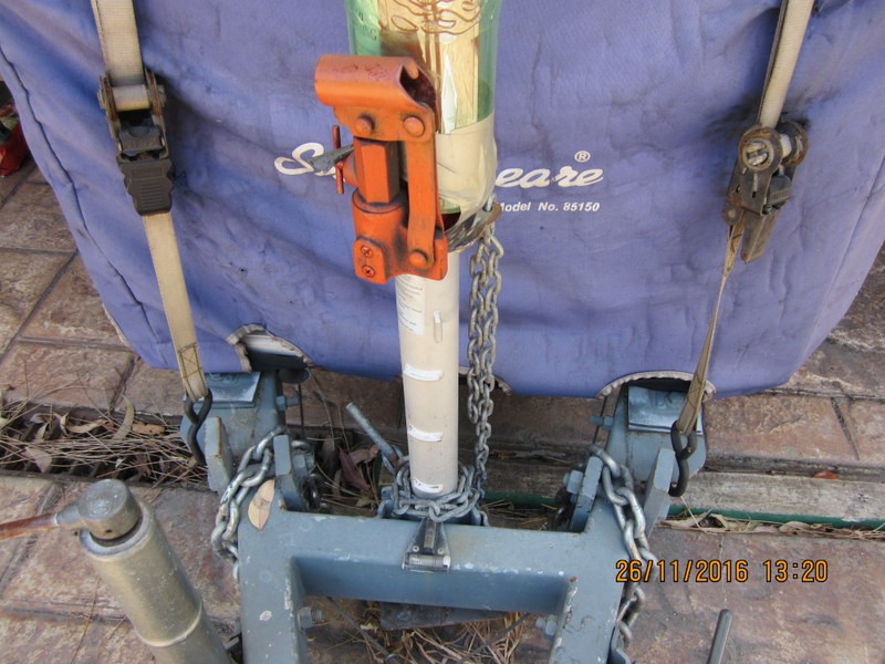

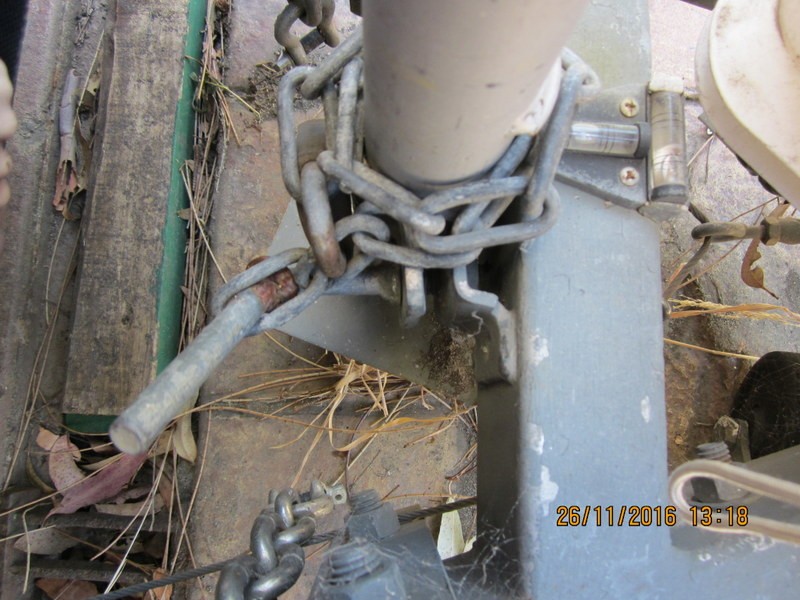

I mount mine permanently on the A frame. To secure same I use a short length of chain and a padlock so the handle of the mounting bracket cannot be unscrewed this needs a washer to be welded to the handle to stop the handle from turning within the chain link.

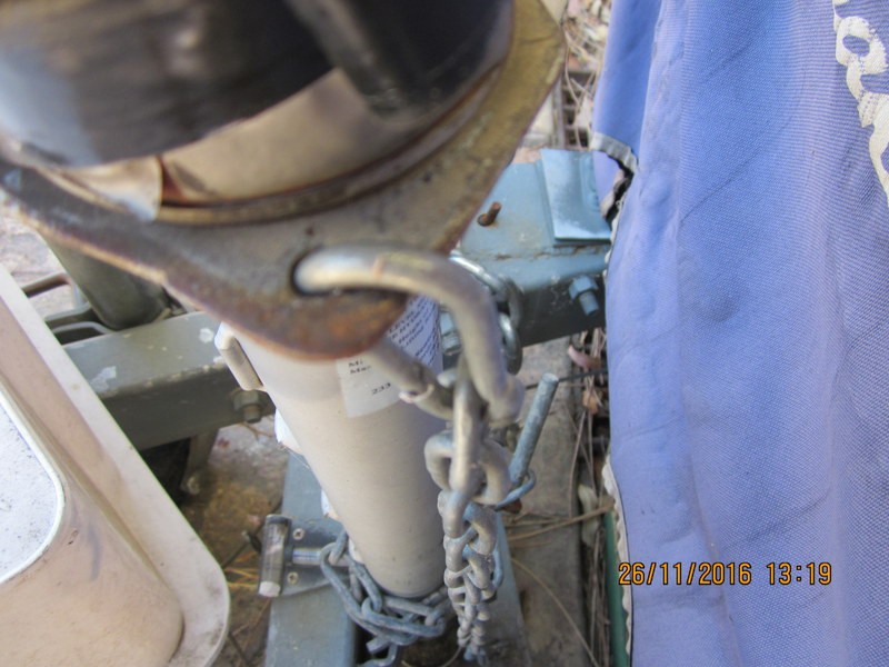

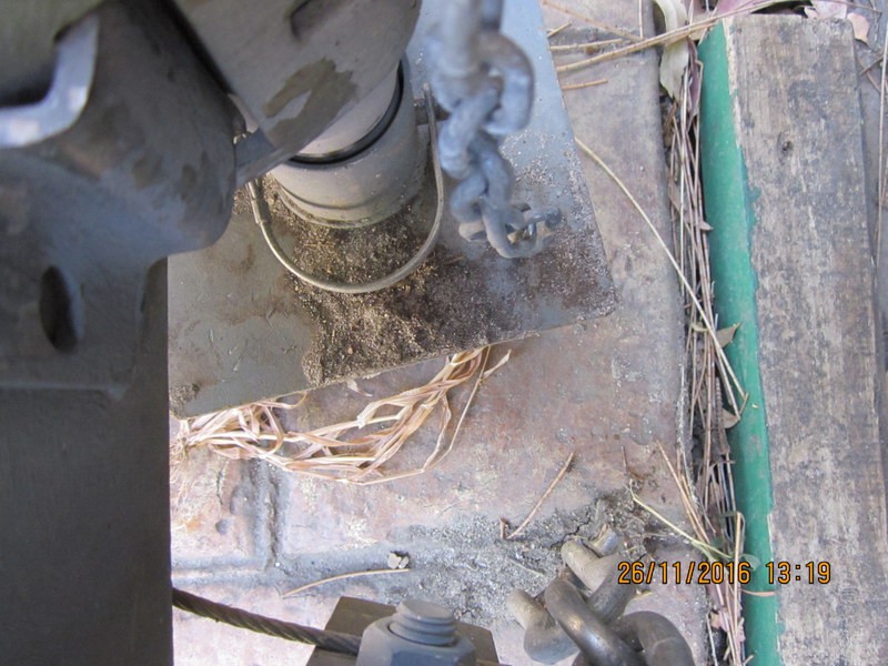

Lighter piece of chain secured to the bottom plate and fastened higher up on the jack with a clip to stop plate dropping while travelling, this is essential as the plate will drop, this chain is also very handy to pull the bottom plate back up into position before travelling.
Leaving the jack in position certainly saves your back as the trailer mate is not that light to lift in and out of the boot.

Roving-Dutchy said
01:32 PM Nov 26, 2016
Hi Phil
Hope these photo's show how it's set up, the chain was welded to the bottom plate at my local Men's Shed.

Hi Phil
Cheers David
