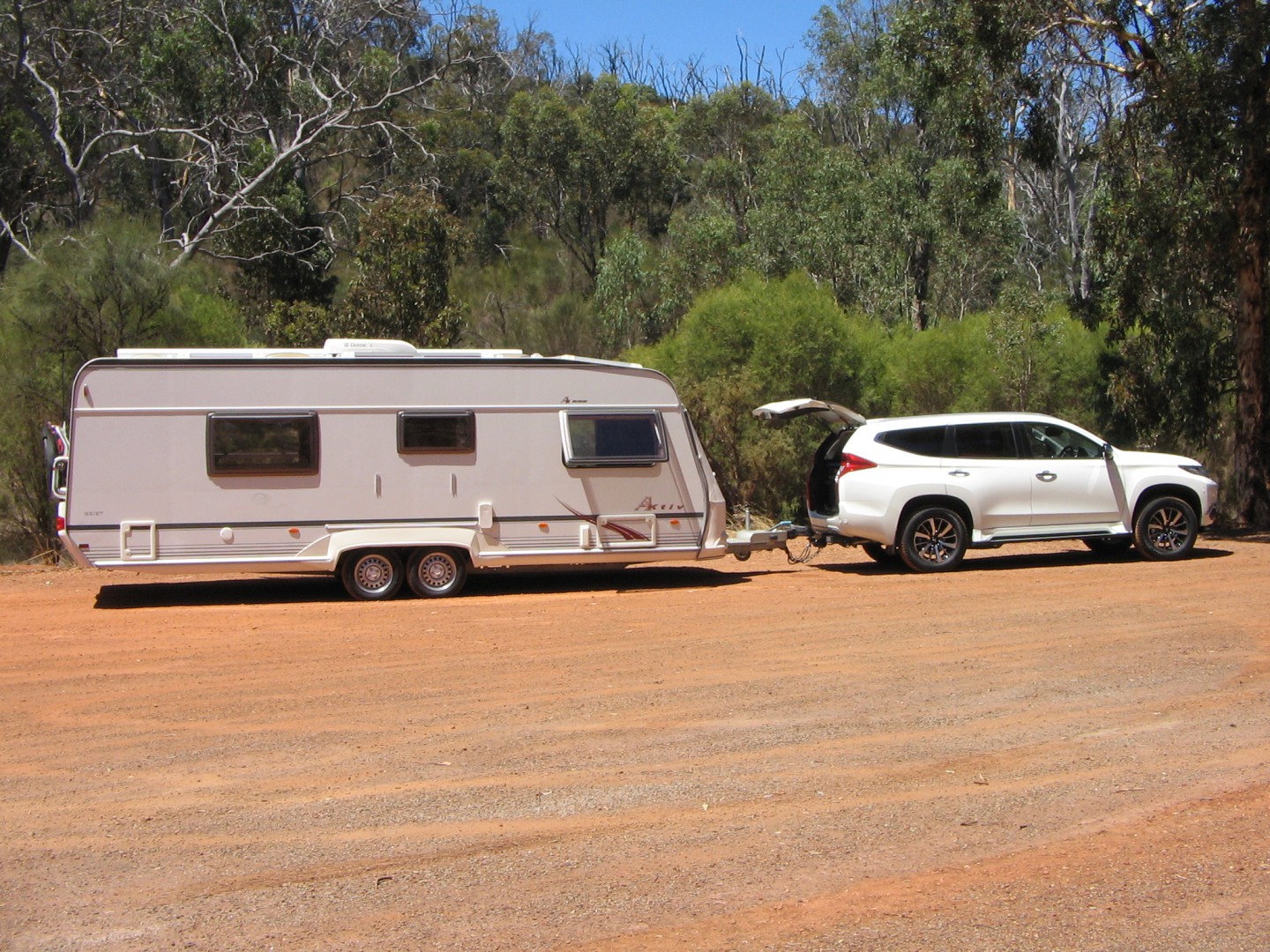

Finalled picked up our new Retreat Fraser from Paravans at Heatherbrae (Raymond Terrace) today and experienced towing the 45kms back home with the Pajero Sport. The vans Tare on the compliance plate (not confirmed yet) was 2283kg which was 60kg heavier than a standard Fraser due to a couple of extra additions. After hooking up the van it was sitting a little down at the front so I had them fit a ProQuip WDH which brought it back up nicely to square. The trip included crossing the bridge at Hexam, a run of about 15kms on the MI (F3) including a long climb, negotiating the city traffic, roundabouts, traffic lights etc.etc. Feedback -
1) From a standing start the sport had to work hard to get up to speed but cruised along nicely once it got there especially on the motorway at 100km/hr.
2) I left it in Auto the whole trip and didn't bother with manually using the 8 speed transmission.
3) There was a bit of dipping when going over undulating road surfaces the van felt like it was pushing the back of the car down a little.
4) I had to fiddle with the brake controller until I found the right setting for it to brake evenly then it was fine.
5) I haven't done the proper figures yet but it looked on the trip computer that it was achieving somewhere around 14ltrs/100kms
When I got home I was thinking about the dipping, then I realised that I had loaded probably around 200kgs into the front boot and under the front single beds including annexe walls, anti flappers, curved roof struts, jack, tool kit, blankets, dooners, privacy screens etc.etc. both front gas bottles were also full, the rest of the van was empty including the water tanks, I had also added the extra weight of a WDH. The Sport itself was empty except for my wife and myself. Hopefully not having this weight distributed evenly but concentrated right at the front of the van contributed to the bouncing.
Verdict - I'm sitting on the fence until I can pack the van evenly and do a proper shake down trip, I already know that the fuel tank is going to be way too small at 68ltrs and I'll have to carry a couple of jerrys. My early feeling is that the vehicle is probably going to do the job but the smaller 2.4 ltr motor will be working hard when it's under load.
