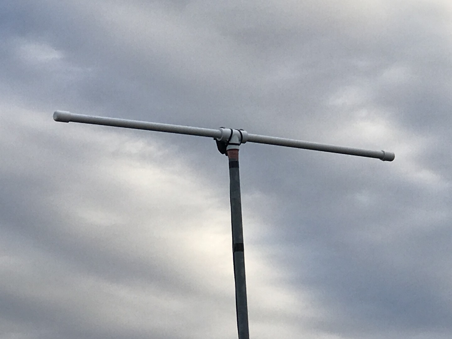

I have tried a few different antennas in my short time on the caravanning highway, and after hours of stuffing around it is still hard to beat this simple antenna!!!
We did 2 trips around the block back in the 1990s, from Perth to QLD and Darwin and a million other places in between, and only ever had the good old faithful $99 Dick Smith antenna. We never missed a beat, I know the Dish is a fashion statement, but we aren't fashionable.
OUCH.

Yes, I have one of those "Happy Wandered" types of Aerials, which I must admit are a usually a very good type to use,
I also have a more expensive one with a mast head Booster attached,
Still no good reception with either where we go fishing, which is about 250km North of Perth and about 100km South of Geraldton on the West coast,
Maybe it's just the area, as there is only one bar communication on the phones in this area, also no radio reception at all.
This situation really makes the Good Woman mad, as she must have the T.V.Soapies as part of her daily life. She now refuses to go fishing again until she has her T.V. !!!
