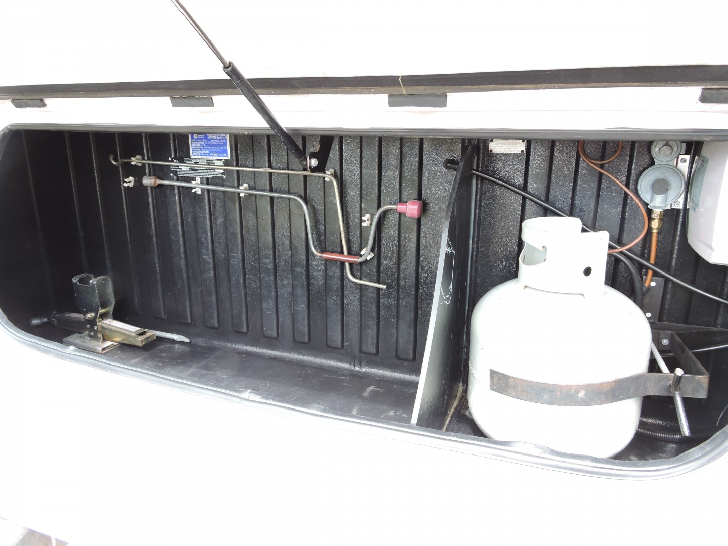

We are needing to get a gas cert. and safety cert. to sell our 2007 Jayco Sterling that we had purchased in Qld in Dec 2012. When we purchased it, it already had a 12v/240v HWS in the front boot along with the gas bottle attached to all the gear eg;regulator etc. Wondering where I can find out when the rule came in about not having anything electrical in the same area as the gas connections. We were very green and thought it was all legal then. Just not sure when the rules changed.

gandk said
07:55 AM Nov 11, 2016
It is actually in the Jayco yard as we speak trying to get the gas cert. They are the same ones who sold it to us with the HWS next to gas bottle and are now saying it has to be moved to get a gas cert. They are saying the regulations have "probably" changed since then (Dec 2012) which they may have. That's why I am trying to find out when the regs changed other wise I feel they should pay for the upgrade as it shouldn't have been sold like it in the first place. I did go and see the rego dept and found the person totally unhelpful. Surprise surprise.
The gas compliance fellow says not even allowed on other side of partition.
oldbloke said
12:33 AM Nov 12, 2016
At bottom of page 3 of the gas guide says 1,5 meters from ignition source, so should be ok to relocate bottle to far side of the boot.Otherwise move to draw bar.
I would be having words with the dealer. These requirements hardly ever change. Perhaps go else where.

adrian foley said
08:13 PM Nov 14, 2016
If it was installed to regulations at the time and has not been altered in any way regulations are not grand fathered.It is a moot point by dealer. regards Adrian.
adrian foley said
08:21 PM Nov 14, 2016
Ignition source to me would be a naked flame,electrical switching etc .The question that needs to be asked is the hws electrical connections sealed or insulated !
gandk said
06:37 AM Nov 15, 2016
Good point Adrian. Will look into that re: no actual ignition source as it is a sealed unit.
adrian foley said
08:34 PM Nov 15, 2016
If it is a sealed unit I would suggest the dealer is talking BS.He is not the authorised person who does the inspection.I have been personally involved in the gas industry as an inspector,trainer and licensed gafitter for nearly 40 years.The fact that it is a sealed unit means that it is separate from the boot.A sealed unit is not considered a source of ignition in any installation domestic commercial or industrial.In queensland the dept of minerals and energy are the state inspectors. regards Adrian.

adrian foley said
08:31 PM Nov 16, 2016
Where does it state in the gasfitting regulations that it cannot be installed there.A sealed unit is not regarded as a source of ignition. Regards Adrian.
adrian foley said
08:37 PM Nov 16, 2016
Regs are slighty different for Caravans.They come under the non propulsive purposes.AS/NZS5601.2:2013.
